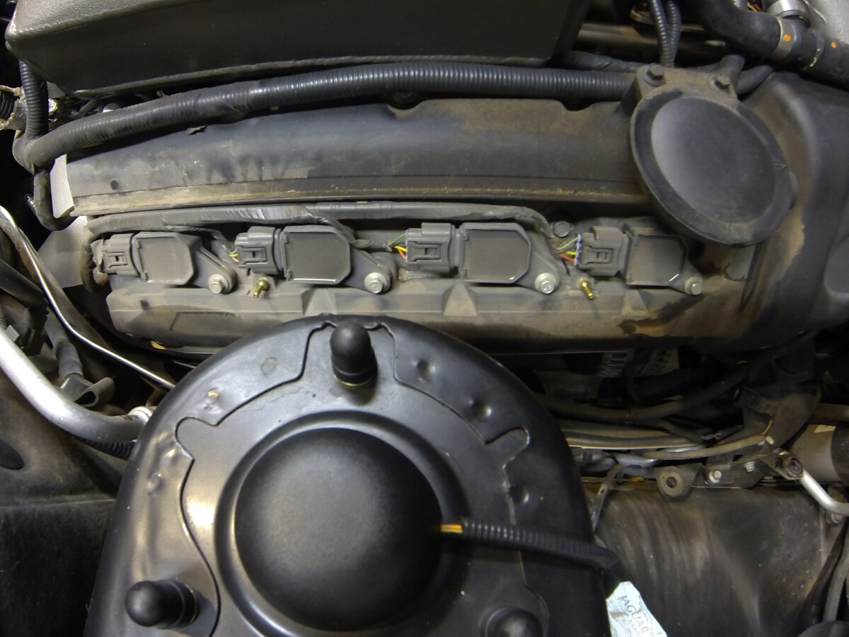

So, there I was worrying about my tensioners and figured why not now to replace them. With this much time on the clock and just under 50k miles I didn't know what to expect. Here's a short post to let you know what I found and ask a couple questions.
Here she is about to get torn apart.
I thought there were 2 bolts holding the intake on.
Question#1 what does this connector go to?
Coil pack cover removed.
Didn't want to mix them up so grabbed some paint and made it easy for me.
Question #2 Did I miss something? I don't remember anyone saying the cam cover had to come off in order to get the 3rd coil pack out.
Cam cover removed and it looks a lot cleaner than I thought.
Oh snap, I already have the updated secondary tensioners, WOOHOO.
I do believe I also have the updated primary and guides as well.
Thanks for all the info, you guys helped a lot.

Don't all 2003 model V8s have updated design (metal) tensioners straight from the factory?

Supposed to, one of the advantages of getting the newer models.

Post 2003 4.2s don't have the plastic tensioner problem, you haven't been reading the forum enough!
