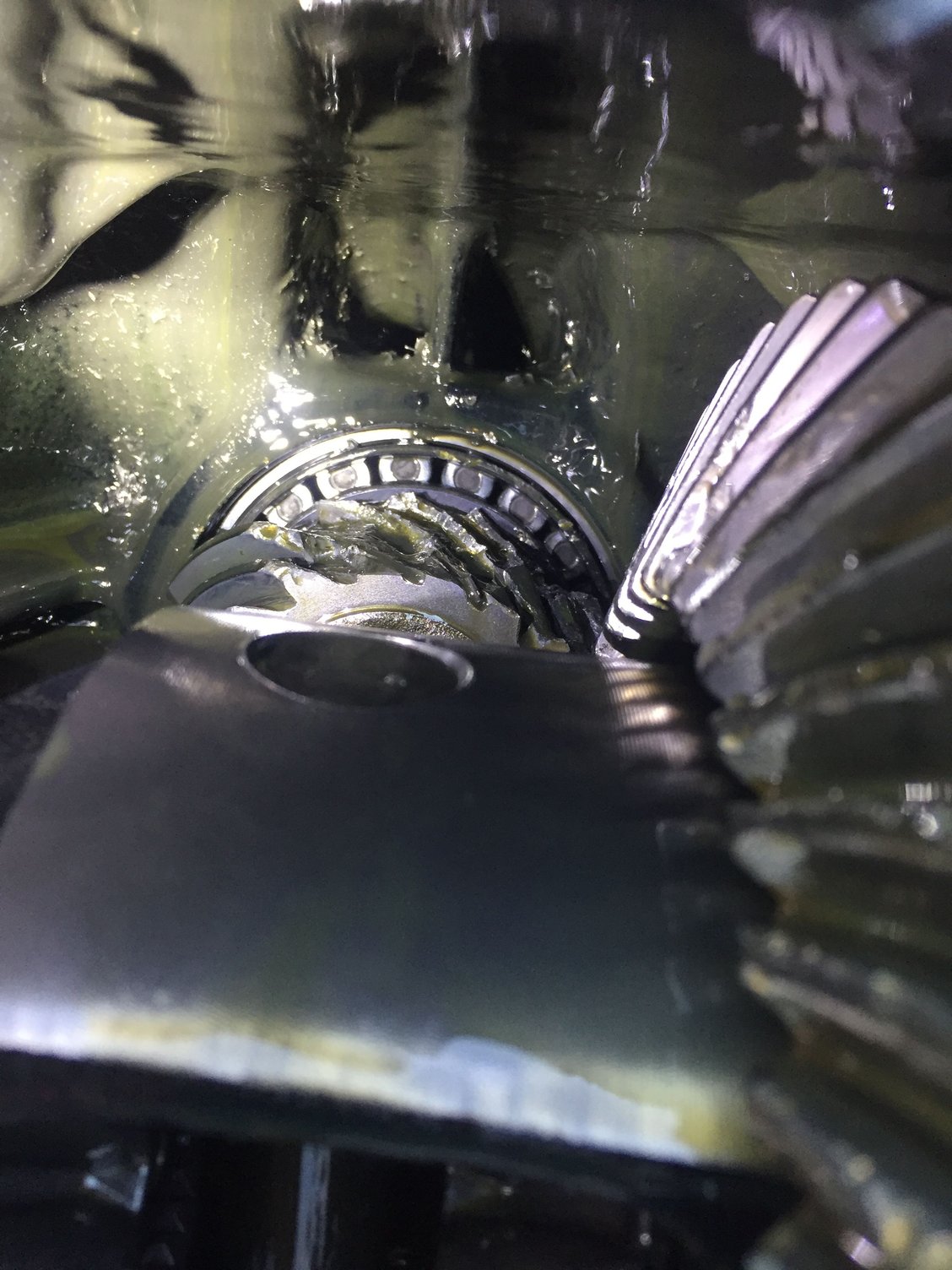

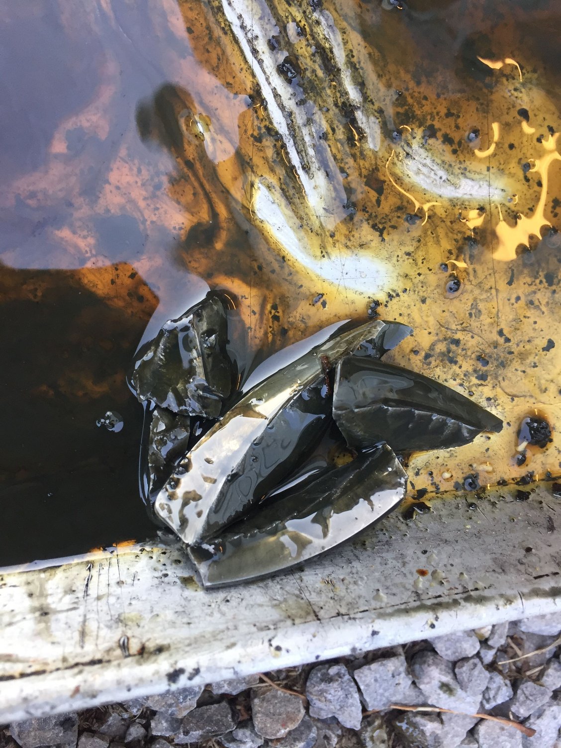

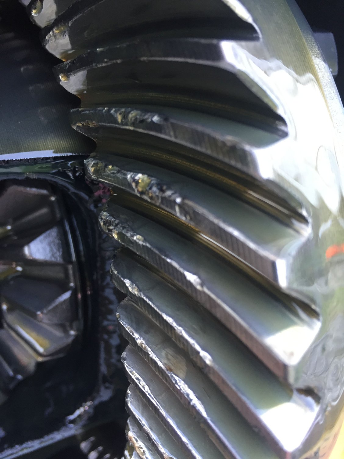

In other news, I stopped by my local tech who had pilled a broken diff out of an '03 - see pix.
Rob
