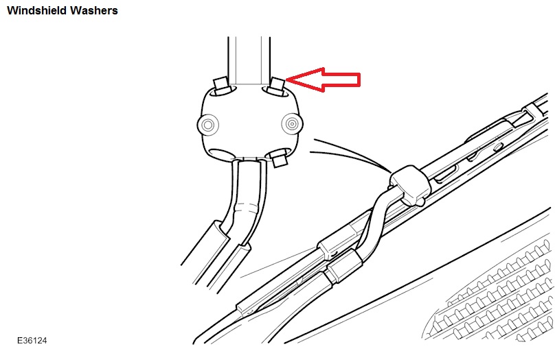

I use a Wiper Arm Removal Tool.
The simplest available is this type ......
......... but I prefer the universal pattern as it gets into more awkward clearances:
As you've checked the pump and supply hose delivers a good stream, the probable cause of no water at the outlet is blocked duckbills. These are the three neoprene outlets at the jet block on the wiper arm and regularly block. One arrowed in red in the diagram:
A blow through with a can of compressed air (the kind sold for PC cleaning) usually resolves the problem.

Great ideas, thanks for all replies. I haven't checked the t connection yet because I need to get the wiper arms off, but like the air pressure for the nozzles too. I have a compresser but probably too much.
