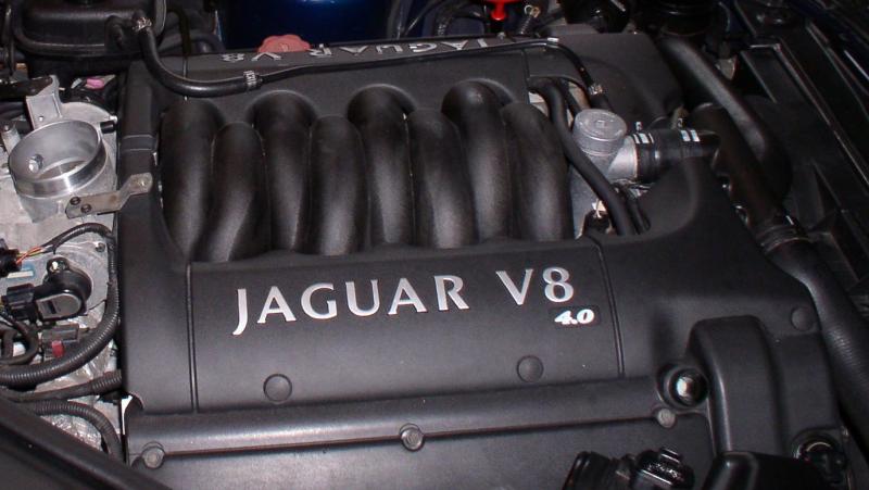

That's about it.
Note the rubber connector at the Throttle Body end which joins the two covers together.
The two round items below 'Jaguar V8' and the one next to the top hose are the rubber fixing bungs which push onto extended studs below to secure the cover. Same arrangement on the other side.

Thank you Graham,
That is exactly what I needed - a picture is worth a thousand words to me because I always overthink things
