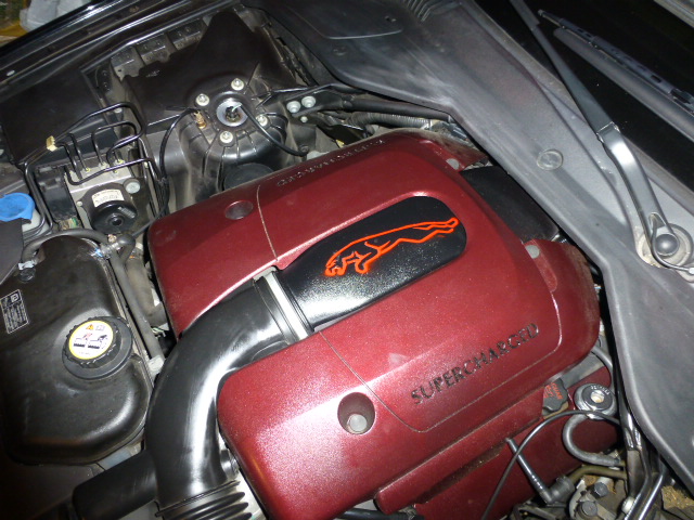

On the underside of my engine cover there is a foam layer covered with black plastic that is glued on.
Just looked more closely. Its pinned/clipped on no glue.

BMW and Rover (which uses a Jag engine) call it an "acoustic cover". That implies it is mainly for noise reduction. So, not "vital".

Originally Posted by philwarner
What material are the covers that say supercharged? Are these normally exposed or are they under the U shaped engine cover on stock supercharged engines?
Aluminum or Aluminum alloy I believe.
They are normally under the engine cover and only the center piece is exposed. However in another post is states that the hood basically covers that when closed.
Thank you 34by151 for your explanation it now makes sense to me.
