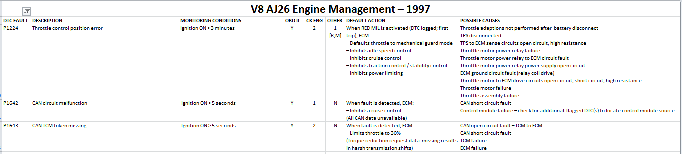

Joe,
you can ignore the P1000 for now as that just means the emissions system checks haven't completed.
The others are:
I can only find P1797 in the MY2003 EG as a CAN error.
Have you had the centre console shift mechanism apart? The CAN routes through the gear selector display and you could have a poor connection in there. Measure across pins 6 and 14 in the OBD connector using a multimeter set to ohms. It should read around 60 ohms. A reading of 120 ohms would indicate an open circuit somewhere along the line. Losing the rev counter could be indicative of this.

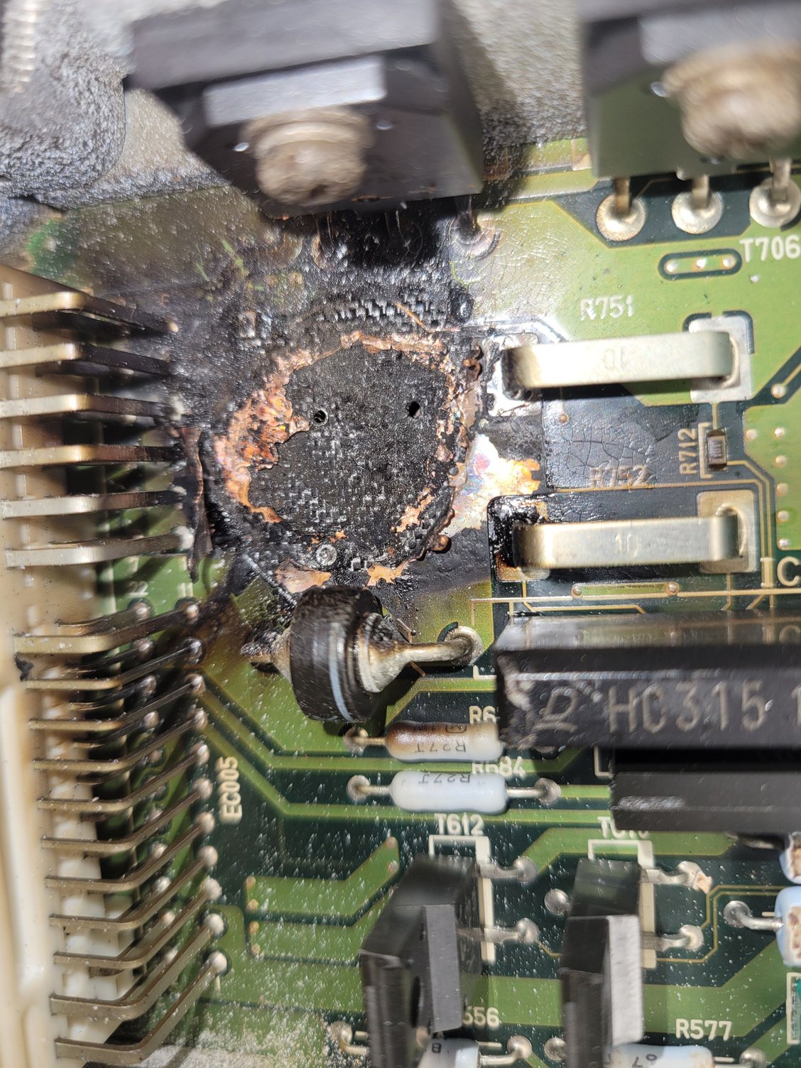

So I opened the ECM and look what i found. Looks like something has blowen up.
Anybody knows where to get it repaired? also i found some ECM'S on ebay for a 1998 xk8. Would that work and do they need to be reprogramed?

Doh! I don't know why the 97 ECMs do this.
I suspect that the module repairers will say it's too badly damaged, although it looks worse than it probably is.
IMO your best bet would be an old skool TV repair man or, possibly, a radio ham - someone who has experience in recovering this type of problem.
Failing that, I'm afraid you're looking at replacement, and the 97 ECM is unique to that year.

I unsoldered the blown capacitor and it melted the circuit board. I was told its not repairable and i can see why. The response I got was "That’s the capacitor that regulates the voltage , It’s smoked to a point that it’s not repairable , Under that compactor within the pcb there are several thin wire traces that run through there once that sever damage occurs we have not been able to bring them back to life . " Found another ECM on ebay with all the same numbers for $150.00. we'll see how that works out.

AFAIK, MY97 in the US doesn't have chip-in-key security, hence the ECM is plug n' play.
However, unless the replacement module has had the capacitors replaced, I would strongly recommend that this repair is done before you fit it to the car.
Please don't throw the.old one away unless it is definitely not recoverable. As 'they' say, they're not making these any more and they're getting harder and harder to find.
Good luck!
p s There's not much circuit-wise going on in that corner of the PCB and it may be repairable
