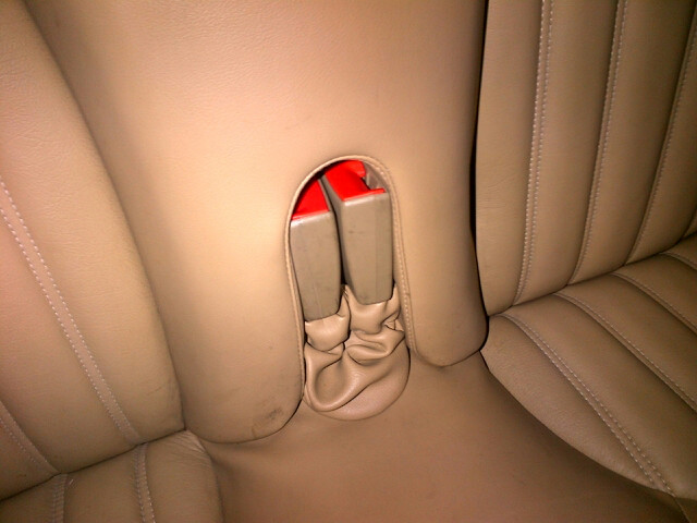

Good luck. Just follow Gus' pictures and instructions. I took my time disassembling the back seat the first time and it took me about 30 minutes to get to the speakers. One tip - my seat belt buckles in the middle of the rear seat have a leather or vinyl boot that covers their bases. This unsnaps so you can gently push them through the bottom of the seat when taking it out. Much easier than unscrewing the mount for them underneath the seat. Very satisfying project if your rear speakers are blown.
