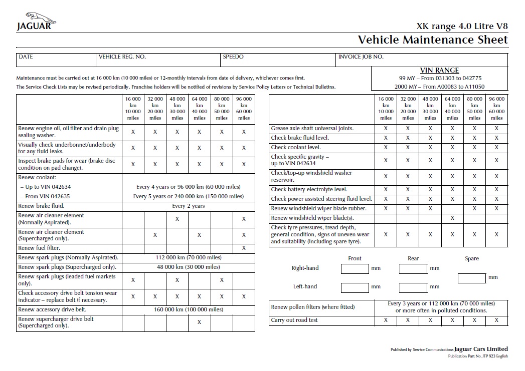

Hi
I have the owner manual but would like a one page checkoff sheet of the recommended service schedule.
Have searched the web but no find.
Where could I obtain such?
Thank you

The recommended service interval is every 10,000 miles/12 months. But, at each service there are different items that need to be checked and replaced if needed. This will depend upon the cars mileage and age. Therefore, what you are looking for (one page) doesn't exist AFAIK.
Use the owner's manual Grasshopper!

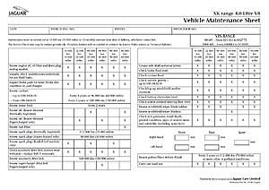

It's all in JTIS:

A free download, too

thanks to all, got 'em
