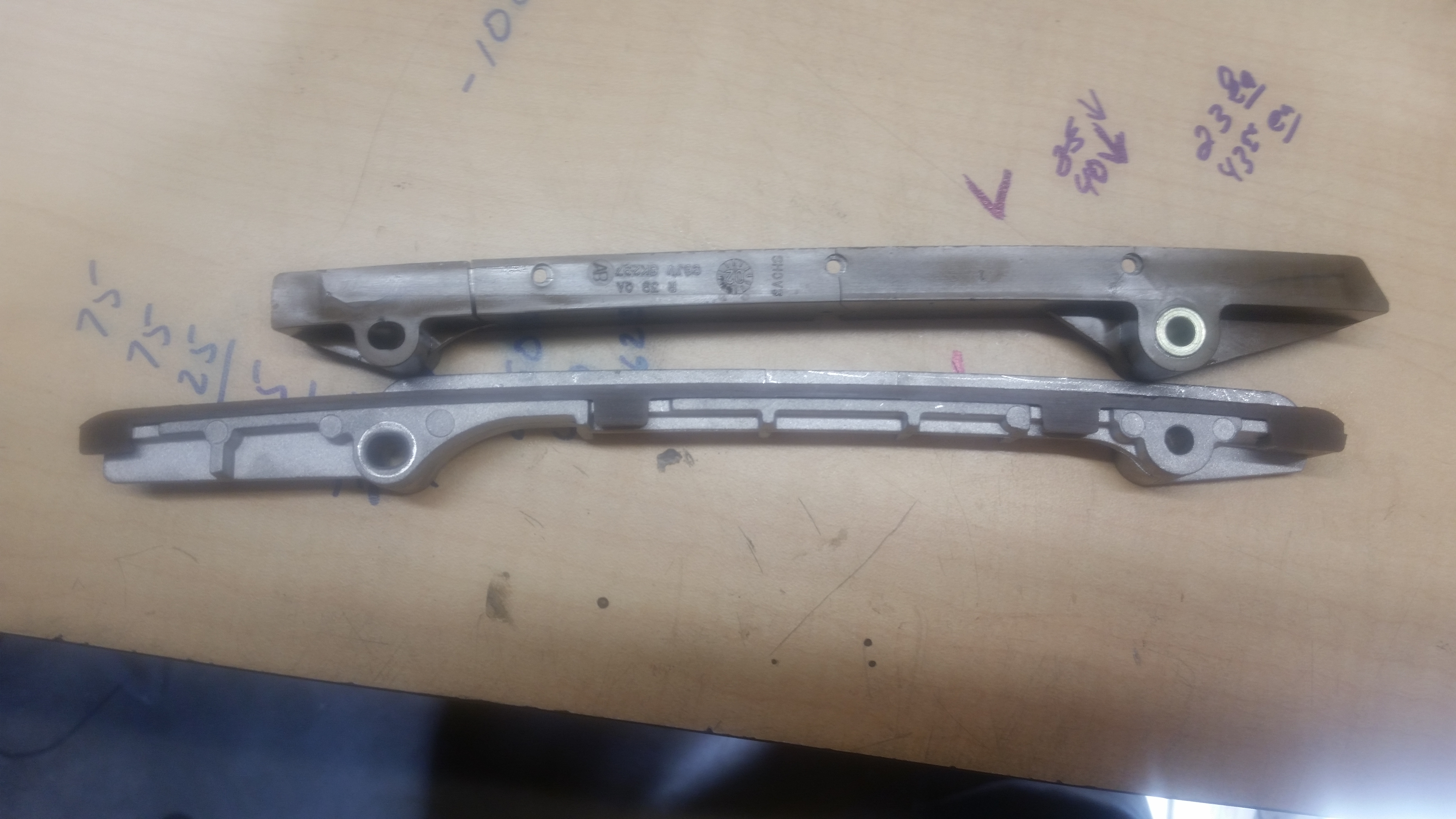

The only difference in the AJ27 and the AJ26, your motor, for what you are doing is the VVT. So that means that my parts list is correct except you won't need the VVT seals for the valve cover.
As for the timing kit the one your talking about has the, in my opinion, the wrong guides. The photo below shows the comparison. The ones in your kit are too long and you have to install them upside down to make them work. The only kit that I could find with the correct guides was a Jaguar kit at SNG # TCK8MAJ/1 that has everything including correct guides for $700. As I mentioned before others have used these guides but I'm not comfortable using them.
All I can figure is those longer guides are for a later model possibly a 4.2L.
In fact if you want my incorrect guides you can have them because I'll never use them.
I made the mistake of buying the timing cover gaskets for a Lincoln LS. Look like they would fit but the is a minor difference between them.
I'm just trying to pass on what I learned from doing my rebuild. I have had no problems, except the transmission is acting up, or any oil leaks.

Thanks for pointing that out RobRoy. Looking at the photos of the kits from CNS and Christopher's, I see what you mean about the guide length and I did view your photos in the thread where you repaired yours and can see that the long guides are not right.
