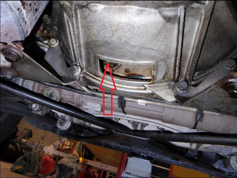

My 1998 XK8 with 90K miles has left a drop or two of oil on the floor daily since I've had it for a couple of years. I just wipe it up and rarely have to add more oil. All of a sudden it started having puddles of what looks like oil, but looking at other threads the transmission fluid can be coffee color also so I'm not sure and not smart enough to know how to tell the difference. it feels and smells like oil to me. Trying to determine the source I found an opening in what I think is the transmission housing that seems to be above the puddle. I wiped it clean before taking the attached picture, but sticking my finger in the opening there is oil inside. Is there supposed to be something covering this opening? There are some other areas slightly wet with oil, but nothing that concerned me too much before. This just started and my oil level hasn't dropped much, but the puddles may only be an ounce or two so it may not show up much on the dip stick. Is there anything I can check/do before trying to find a shop to take it to?

It looks like oil coming down both sides of the transmission so I would be looking at the cam/valve cover gaskets first. You can check by reaching down below the rear of the cover when the engine is cold and of you have wet spot you found it.

What is the opening for? There are wet areas on the side, but don't appear to be dripping and I would think it would be hard for oil to pool inside the opening if it was dripping down the side. I did find some oil in a couple of spark plug recesses months ago, chasing a fault code but don't see any drips from that area.

The opening is to allow access to the flex plate bolts.
If the oil is not coming from the cam cover(s), it could be the rear main crankshaft seal, or, if it proves to be gearbox fluid, from the front pump seal.

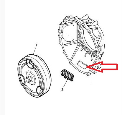

Old Oct 16, 2017 | 05:18 PM
Originally Posted by klynn
What is the opening for? ....
The opening at the bottom of the bellhousing allows access to the three torque converter securing bolts (one of which can be seen in your photo):
It is normally covered with a black plastic mesh stone guard (see item 2):
This guard just clips in.
