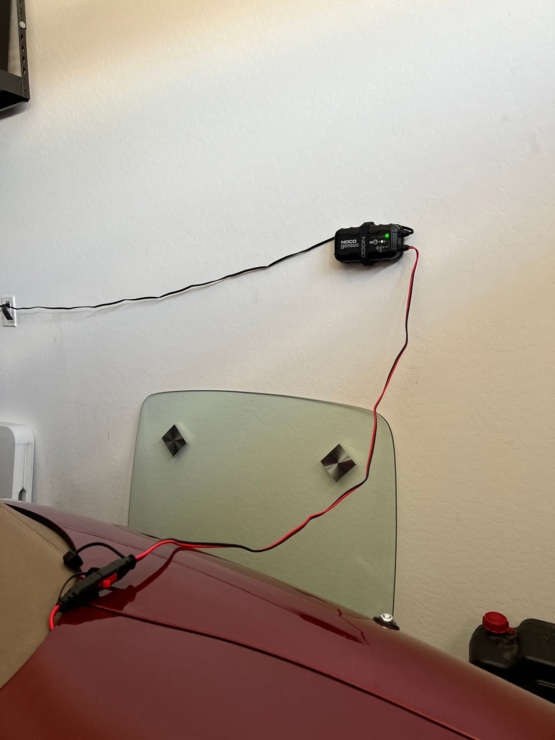

of course I missed that. Murphy’s law right. Do I just connect this to the battery and leave it on it with the direct wires assuming it recharges itself when the cars on? Or are we talking I need to take and plug it in every time? Could I just plug it in to the cigarette lighter? Trying to read up on it but not really understanding. Usually not this stupid with stuff but a little puzzled for sure.

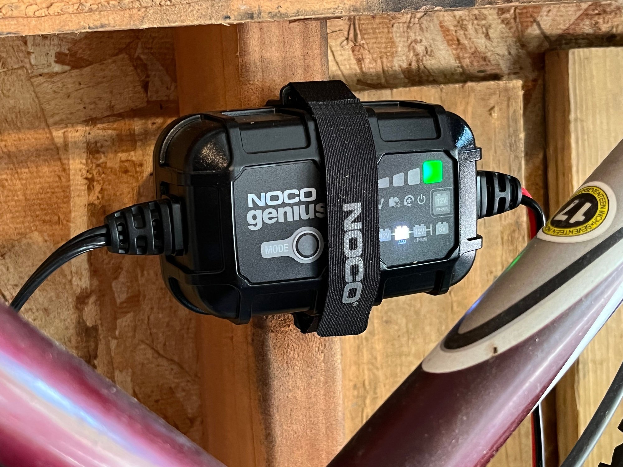

the battery tenders run off of wall current, 120v in the USA.
the cigarette lighter is a no go as it’s disconnected when the ignition is off.

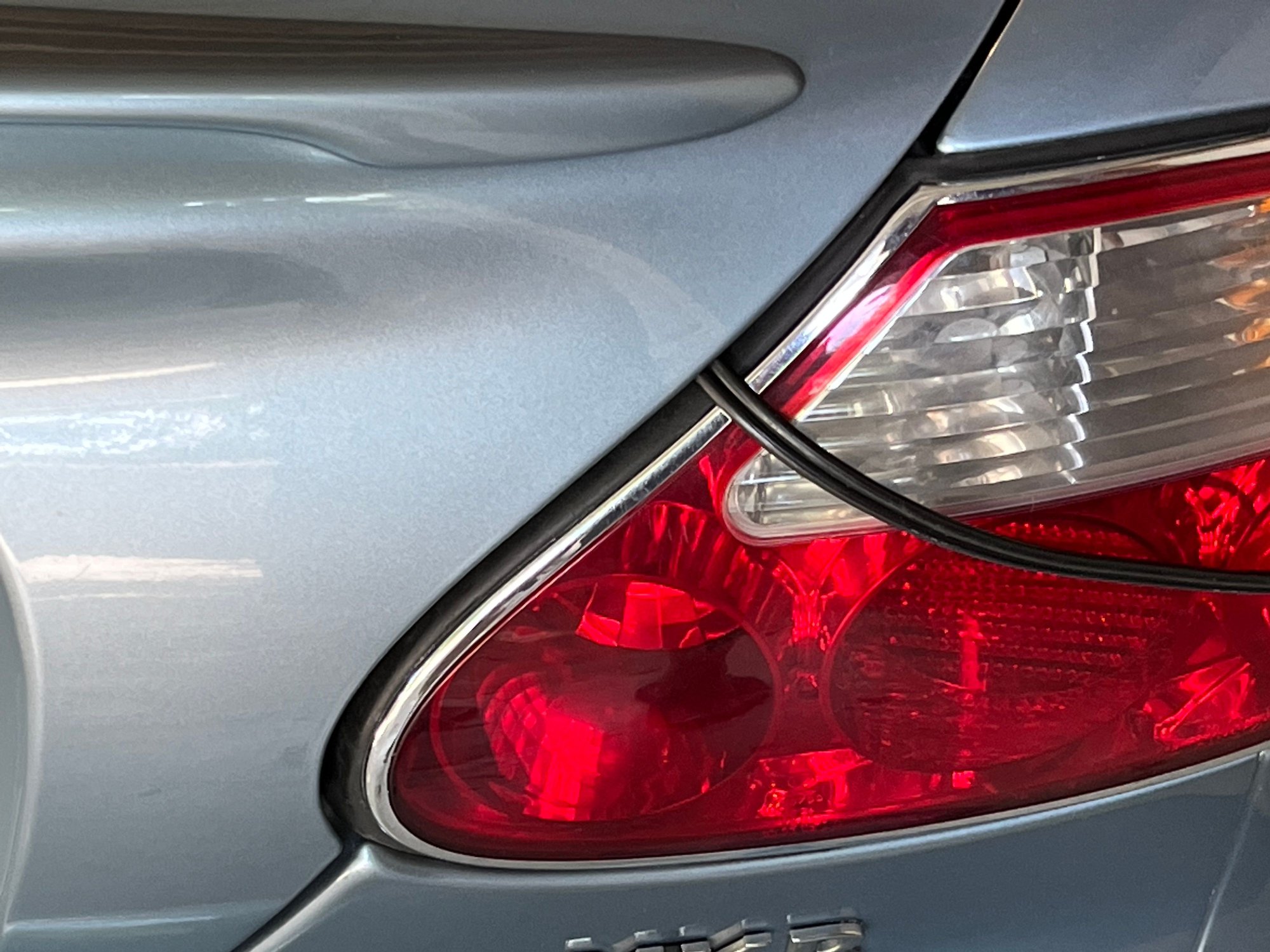

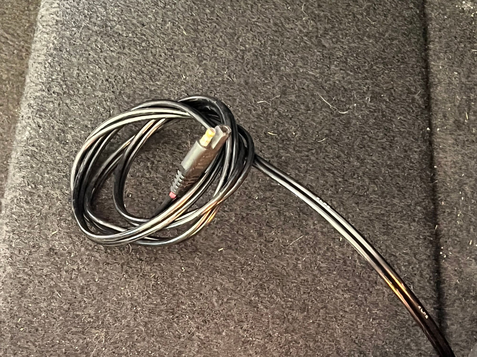

I have the tender wiring hooked up to the battery full time, with a connector midway between the tender and the battery. I run the wires out of the trunk lid. It’s perfectly alright to shut the trunk on the wiring. The trunk seal is very soft and flexible. The wires are not pinched, ie you can still move the wiring in and out of the trunk with the lid closed, it’s that loose.
When I’m going to drive the car I just pop open the trunk, disconnect the midpoint connector and I’m off and running. Takes all of 20 seconds.
I’ll add photos shortly, which will hopefully add clarity to my meandering description.
Z

All set up. Had to come out the top like that due to the length of the cord even with the extension. Plus I figured that way if I forget to unplug it it’ll just unplug itself without causing too much damage. We’ll have to see what happens next time I’m sitting in traffic and shut it off or get gas after waiting in the massive Costco line. Fingers crossed.
