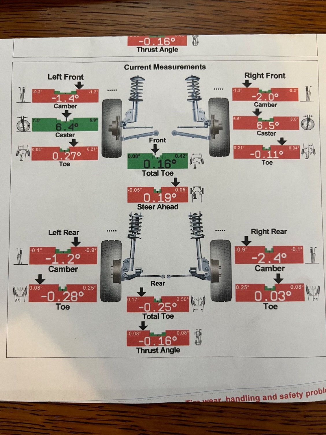

These are the alignment specs from the shop that couldn't do the work:

Does anyone have any input on the alignment specs in the above? Are they super bad?

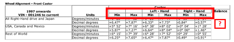

I attached the alignment specs from the 2003-2006 shop manual, apparently the specs stayed the same from 1997 forward.
Looks to me like your rear toe is off by more than a little bit.
I'm struggling to fully understand these tables though. For example, why are there three different min/max columns for front/rear camber, and front castor (screenshot below)? Why isn't there just a left and a right?

If you use this link, (courtesy Gus)
http://www.jagrepair.com/images/Auto...sb_09_2003.pdf
then you will find the same info, but presented more clearly, explaining the third set of figures.
Using the link to Gus's Home page JagRepair.com - Jaguar Repair Information Resource will no doubt be of use to in many situations
Hah, I should've known to check at Gus's JagRepair before asking.
And now I understand why the shop manual tables didn't make sense; the headers are mislabeled.
