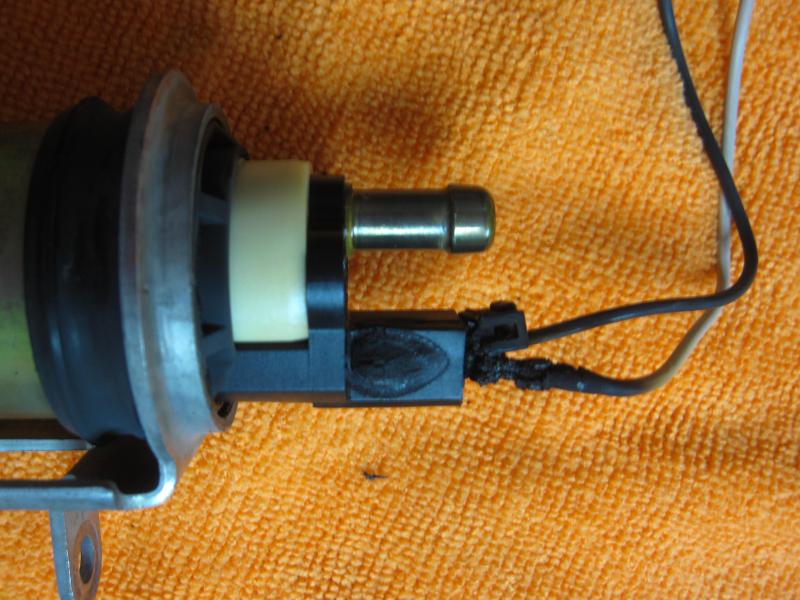

I pulled the fuel pump out, and the wires going into it were all charred and melted...scary. I've got a great pic, but it won't upload(too large a file maybe?).

Default Yikes
https://www.jaguarforums.com/forum/a...1&d=1347633783

I've put the fuel pump pic full size in your post.
Very scary.

Default vroom vroom, all done!
I swapped fuel pumps going through the speaker hole like others have done on this forum. The only sketcky thing I did was re-use the good parts of the burnt/melted wire harness leading to the fuel pump. I spliced it into the new wires, and its working fine...so far(see pic). I saw on the forum that wire harness from the dealer costs a ridiculous amount. The total cost for the job was $106.83 at Autozone(Airtex fuel pump and Airtex fuel strainer).

Default new pump with wire splice
new pump with wires spliced into the good parts of the old burnt wire harness.

good repair dave! we appreciate you sharing your experience and 'tips'

Dave,
Very neat harness splice and low cost repair.

You did a nice neat job. You are right that the replacement wires are outrageously priced.
I do not want to be a 'Debbie downer', but the only thing that worries me about your repair is whether the plastic insulation on the crimps can survive living in a bath of gasoline. Time will tell.

There's no accounting for connectors from various manufacturers but I've installed similar, normally supplied with various replacement pumps.
