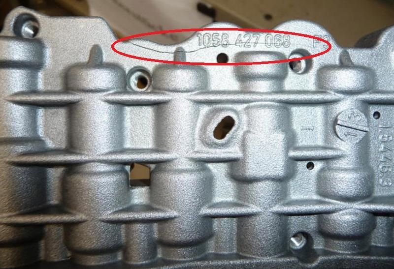

To close this one off I recently took the hit and had the gearbox rebuilt. Turns out the valve body top section had cracked and it was causing oil starvation in the gearbox. All back to new now, took a while to source that specific valve body, had to find a donor transmission.

Curious:- was the crack in the usual place?:
Very good question - honestly I don't know. Let me see if I can confirm with the tech who did the job.
