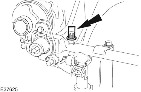

You should first check for fuel pressure and you can do this by going to your local AutoZone or alike and rent a fuel pressure gauge. You will need to install it on the fuel shreder valve http://www.gusglikas.com/AutoRepairF...SType99XK8.htm Your comment is leading me to believe that your fuel pump is not working if you find that you have pressure you should check for spark. Your year car is leading me towards a cylinder washing situation but will not go into that direction until you check the fuel pressure first.

The Fuel Pressure Schrader Valve is located at the REAR of the Right side Fuel Rail on N/A XK8s
