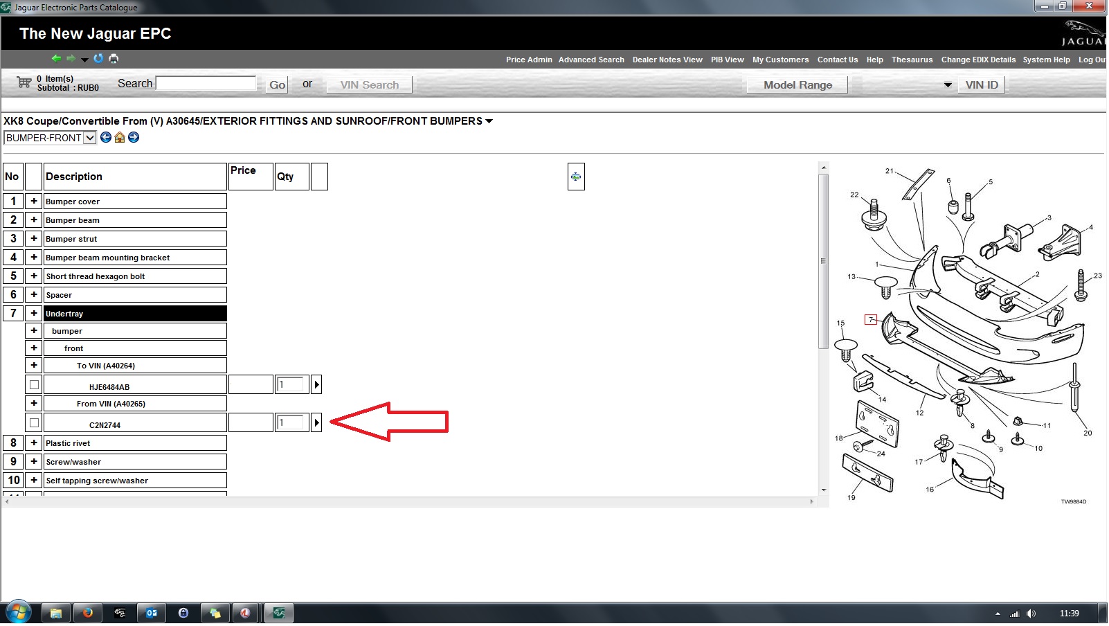

so i bought an undertray from 1997 xk8 to fit my 2005 the parts guide shows it should fit....i even bought a jtis to find instruction how its installed. however, i spend about 30 minutes under the car figuring out how it should fit....the design on the 2005 bumper seems to be different....anyone out there could help me out and take a picture of underneath yôur 05?
are the valance between 1997 and 2005 different?

Yes, they are different, front bumper changed in 2004.

Different front and rear bumpers on the 4.2 model.
It's confusing because the Electronic Parts Guide uses the same Front Bumper diagram for both Model Years but note the different Part Numbers. There's even another Undertray change during the 4.2 production at VIN A40265.

Dang! no wonder I was puzzled to no end... I constantly doubt myself..."It can't fit" ...but it's got to fit the parts guide say so...haha..yeah I finally pay attention to the parts guide and C2N002744 is what I need then?
That should be the one for your VIN on a 2005MY.
Good tip from both Jandreu and RCSign. You shouldn't have any difficulty getting your money back on the earlier Undertray.
