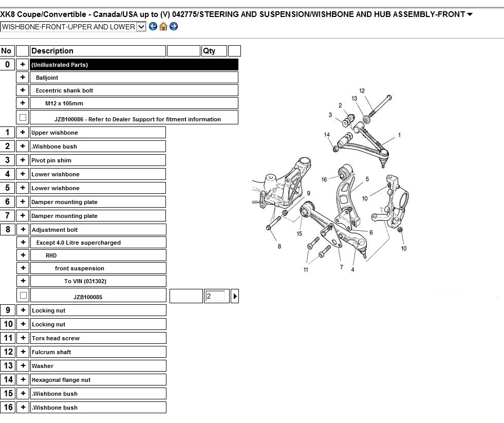

Hey,
Does anyone have a part number for the front eccentric bolt?
I have found two numbers JZB100086 and ...85. The first is about $40 and the second is about $80.
Anyone know if these are interchangeable?
Thanks,
Rick
Old Aug 13, 2013 | 09:16 AM
Likes: 17,016
From JTIS:
"Camber setting is adjusted by rotating the lower-wishbone rear fulcrum bolt, which has an eccentric shaft. However, in some markets the eccentric bolt is not fitted and the original fulcrum bolt has to be substituted with an eccentric bolt to enable adjustment. The eccentric bolt is supplied by Jaguar Cars Ltd."
You have identified the Part Numbers correctly for item 8 and the alternative eccentric shank bolt:
The major cost difference is probably because JZB100085 is the standard bolt and JZB100086 is the eccentric bolt.
I can find no reference to the use of the eccentric shank bolt in JTIS which suggests two things:
1. it is fitted only if required during manufacture to compensate for variations in front cross member / mounting geometry
2. instructions for retrofit will be the subject of a TSB (Technical Service Bulletin)
