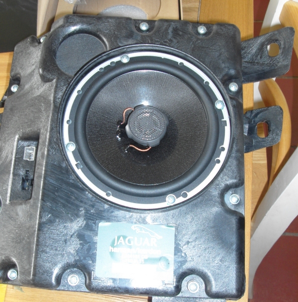

Not sure about the MY2000 Alpine Premium system, but my earlier Harmon Karden system has TWO speakers in each of the enclosures beside the rear seats - a sub-woofer and a mid-range unit. They are fed by separate wires from the amplifier and are not on a passive crossover within the enclosure.
So :
2 x tweeter (by door mirrors)
2 x Squawker (Jag's word not mine) on fascia (in parallel with tweeters)
2 x Mid-bass in doors
2 x Rear mid-range
2 x Rear sub-woofer (only 1 in coupe ?)
That's a 1997 Harmon Karden Premium system. I'm pretty sure that when the Alpine system was introduced, the speaker enclosures were "discarded" and replaced by a flat panel, so maybe they replaced two speakers with one at the same time ?
Picture shows mine after replacing originals with new drivers. Smaller speaker grille can be seen above larger bass unit.
So :
2 x Rear mid-range
Attachment 113473
Cheers,
David.
Alpine systems just have the subwoofer. It is in a box, but the face is flat, as you said. I was trying to find a picture of mine, but my hard drive crashed and those photos were on it.
