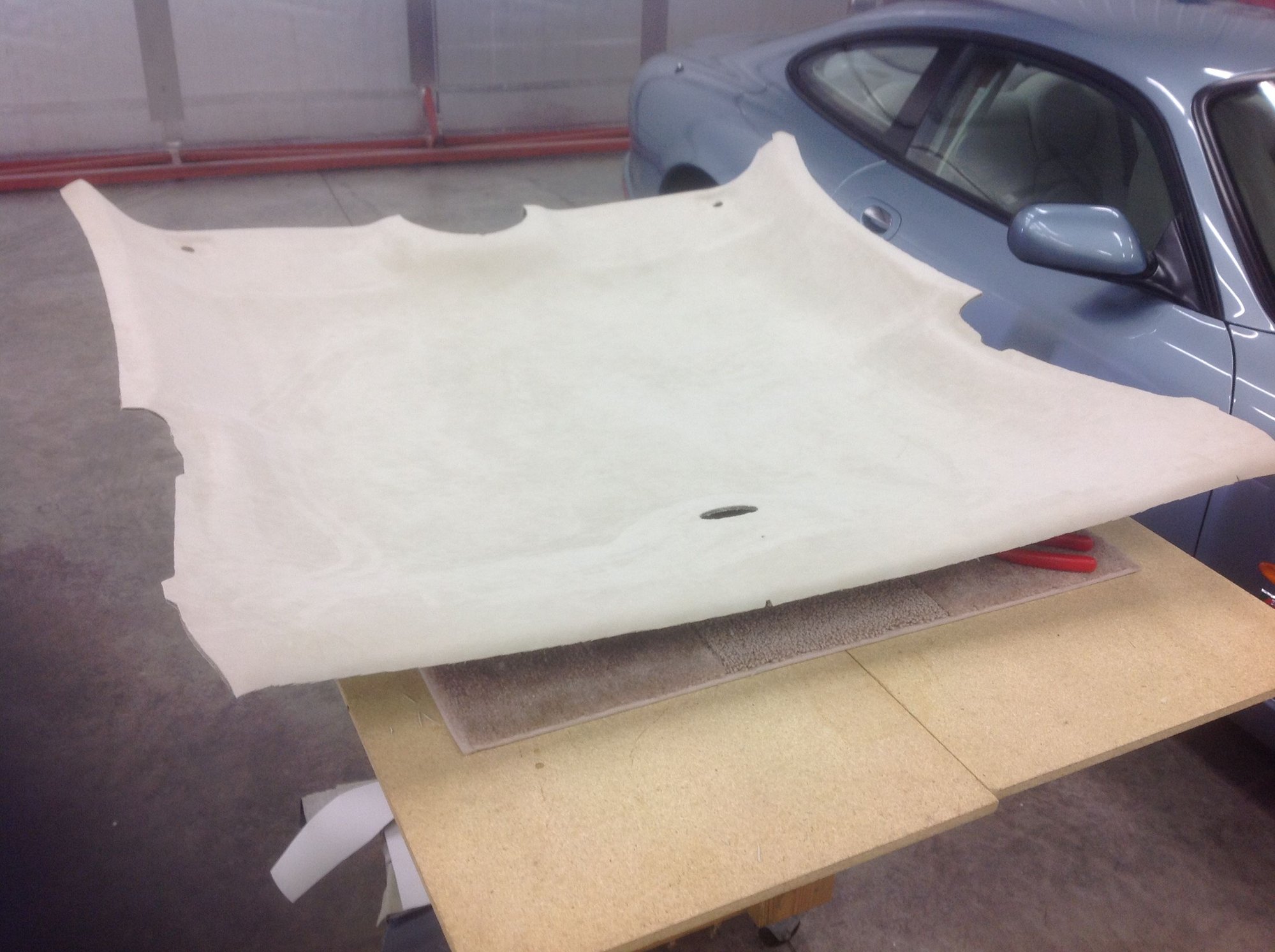

This is the headliner from my 2005 XKR recovered with genuine Italian Alcantera and ready to be reinstalled. I'd done this before with the normal headliner material, but working with Alcantera is at another level. Looks beautiful when done, but frankly, it's not easy.
Would I do it again? In a heart beat, like I said, it's beautiful!
Now for the A pillars...
