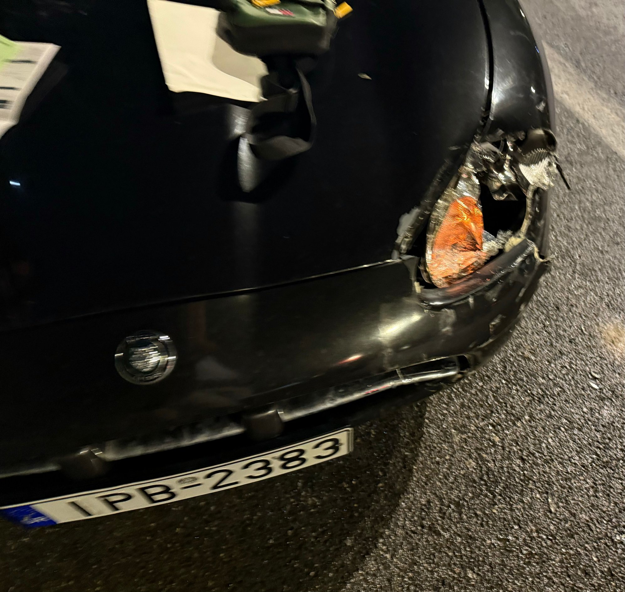

Default 2001 xk8 front right headlight assembly replacement
Accident damage last week in Athens
[img alt="Maybe more detail
need a working headlight assembly in Athens if
possible to do the repairs"]https://cimg4.ibsrv.net/gimg/www.jaguarforums.com-vbulletin/2000x1504/img_6218_f608827abb39438f6dcdd70316208b13e41898d0. jpeg[/img]
Maybe more detail need a working headlight assembly in Athens if possible to do the repairs

You need a LHD but if you cannot get one you can dismantle a RHD and re make the bit of tin in front of the bulb which differentiates L from R
