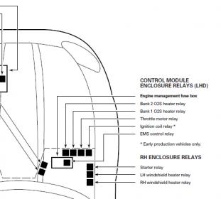

How can I tell if I'm supposed to have a heated windshield? Can I tell by the VIN? My windshield was replaced a while back and now I'm wondering if they might have replaced my original heated windshield with a non-heated one.
Old Mar 23, 2011 | 08:56 PM
WhiteXKR's Avatar
Joined: Apr 2010
Posts: 7,657
Likes: 3,021
From: Arlington VA USA
Check for the relays.

I noted that my 2001's Driver Handbook shows the control as optional - see control 11 on the Climate Control page (2001 XK Climate Control | Flickr - Photo Sharing!). As it turns out, mine doesn't have that control. I'll go look for the relays too.

Just confirmed that mine does not have the heated windshield. I started with WhiteXKR's relay diagram; the two heater relay slots are empty. There's no "Heated Front Screen" button. And there are no fine lines in the glass.
