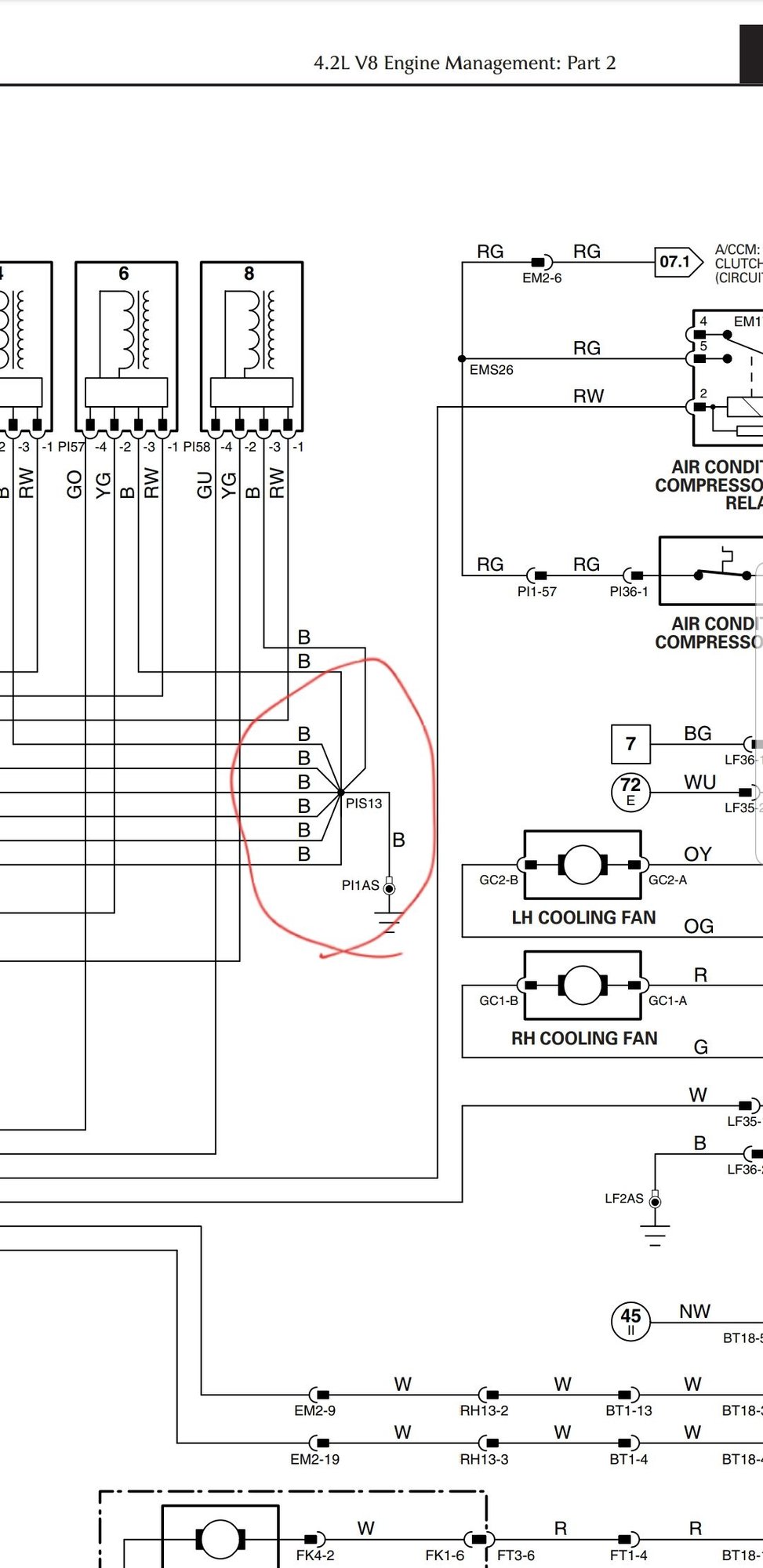

I'm looking at the ED for the 2004 4.2, apologies... And for the life of me (I don't think it listed) I cannot find the ground location PIS13 listed in the diagram. I think it's missing.
Anyways,
I'm thinking there might and must be something similar in the 2001. I have a NA 2002, but am at work and don't have access to the 2001/02 diagram. Maybe the same, maybe different.
That's a LOT of codes which leads me to a grounding idea OR,,, what plugs and coils did you use?

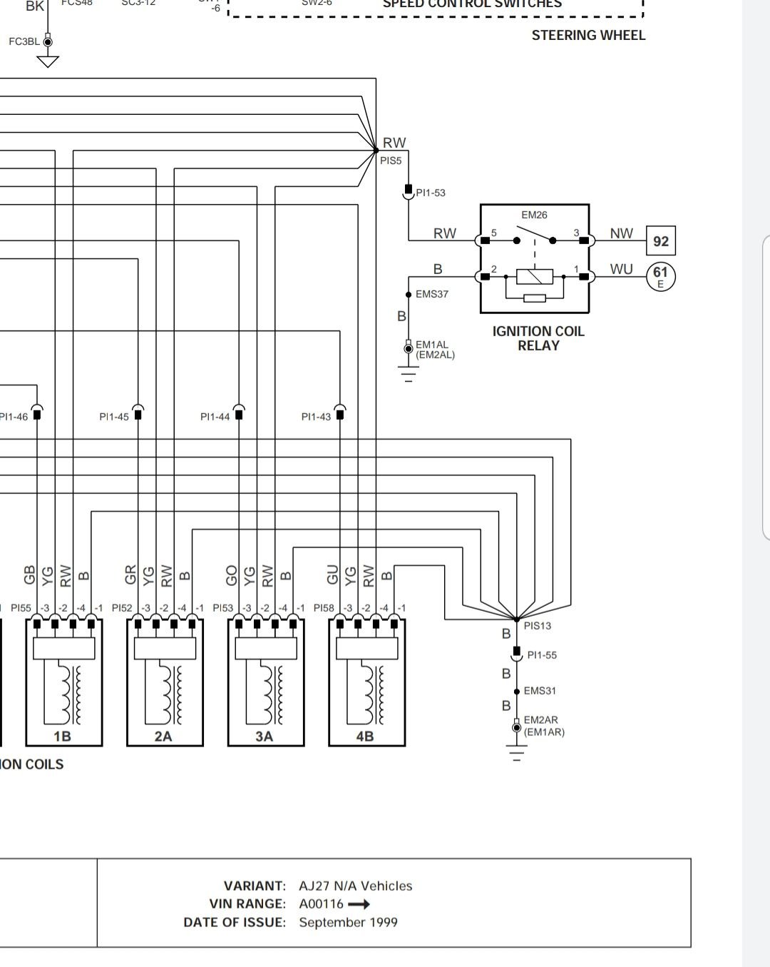

No worries. This is from the 2000my ED...

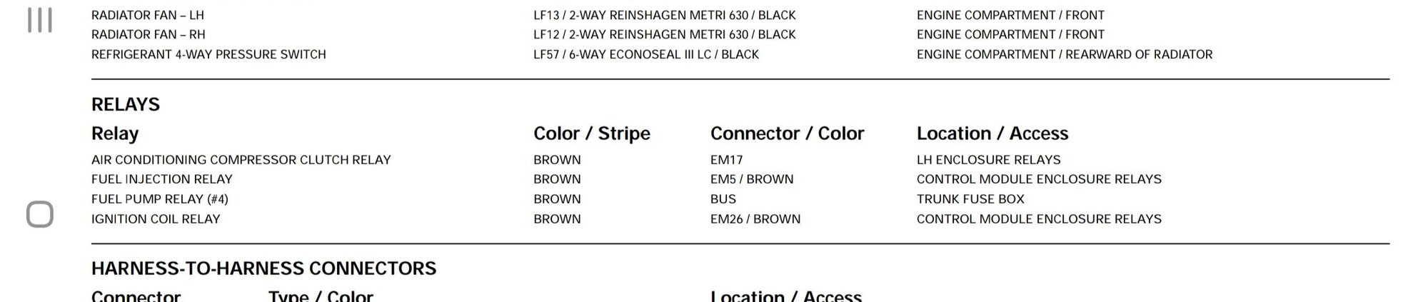

​​​​​There is an ignition relay. See below. Maybe swap it out with a known good relay, maybe horn or something, and take her around and see if she plays up...?
Was this happening before the coils and plugs were changed. It's an important point. Anyroads,,,,

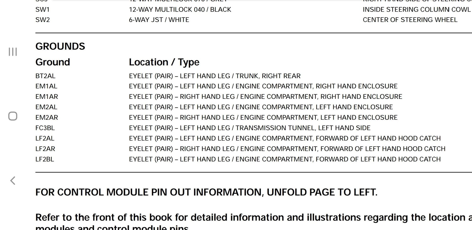

I'm sorry. Maybe someone with more experience than me will help. I am having a hard time using the FIG 4.3 diagram key to give a description of where the ground points for the ignition coils (image below) are located... Hopefully someone else will fill in my blanks. Maybe all of that is only grounded within the ecm...?
Old Mar 25, 2022 | 09:24 PM
JayJagJay's Avatar
Joined: Sep 2016
Posts: 4,277
Likes: 1,314
From: New York New York
Here. Try these and match them up with the grounds in the image above.
