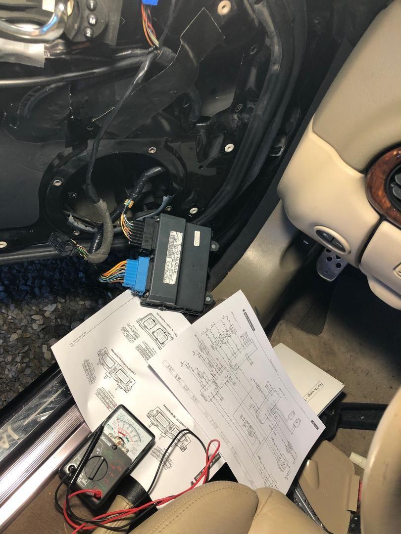

Had my 2003 XKR Coupe on the road yesterday and out of the blue everything in the driver's door stop working. Car thinks door is closed [I guess], no fob, no windows [drivers or passenger buttons], mirror buttons, lock mechanism....nothing. No button works on the driver's door.
Can lock/unlock with key to open it but the window does not drop nor the door latch function. I had to use my hip to close the door with a hand pressing the window inward to tuck into place and climb in the passenger door. Not fun!
Fuse ok [#15 25Amp] in driver side fuse box and WD40 in latch did nothing. Battery disconnect did not fix either.
Passenger door works fine on its own.
DDM part#LJE2120AB seems to be a hard find but could that be the only culprit?
Had a 1997 XK8 with the microswitch issue but that did not kill every driver door function like this.
Would appreciate all advice & guidance.

Always go for the simple first ..pull the door card . The cotroller is top near the hinges. move it down and check it has live and earth ..dont pull the plugs while you do this . Diagram / pin out on jagrepair.com . If it has live and earth then I would change the box about $50

The module gets live and earths so wiring intact.
Go I guess I need to go shopping
Casing manufacturer's logo is the blue oval so I'm hoping this module is same as in a Ford and therefore not 'Jaguar' priced.

You could try swopping it with the passenger side one if you don't mind risking the other door card clips.
It looks like the case clips together - is there anything obviously distressed inside?
