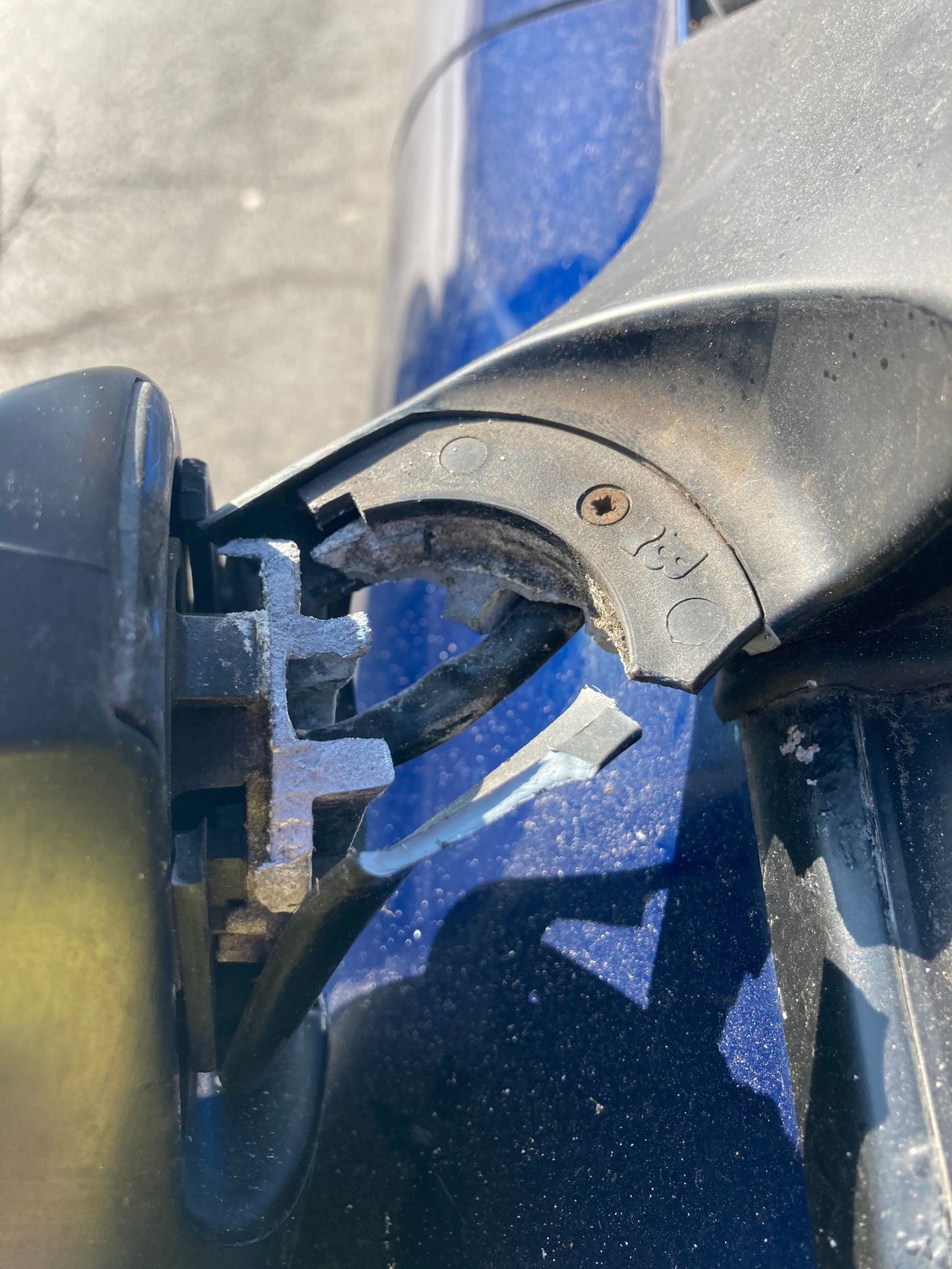

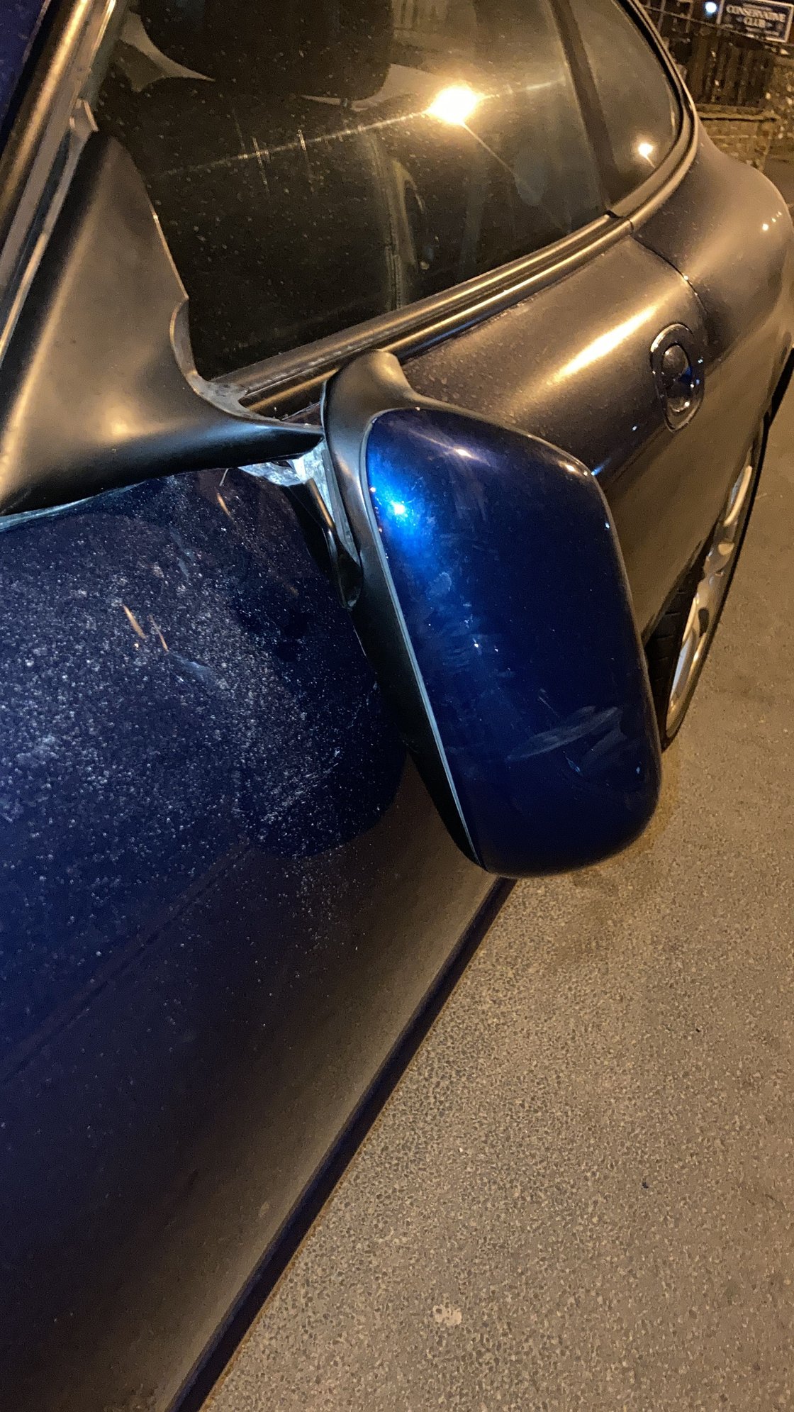

My 2004 xkr was the victim of some yobs last night braking my wing mirror. I’m trying to identify the correct pn for a replacement and hoping someone can check the below.
The pacific blue back cover is good enough to be put onto a new one as the only bonus.

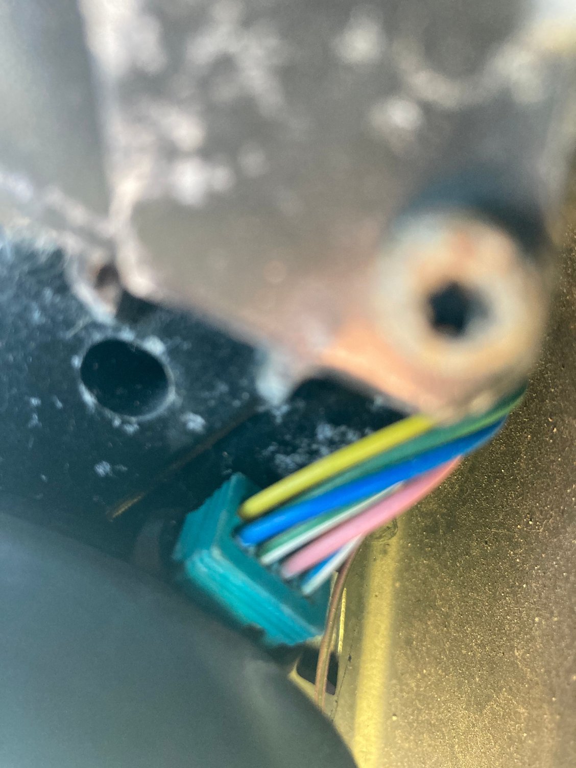

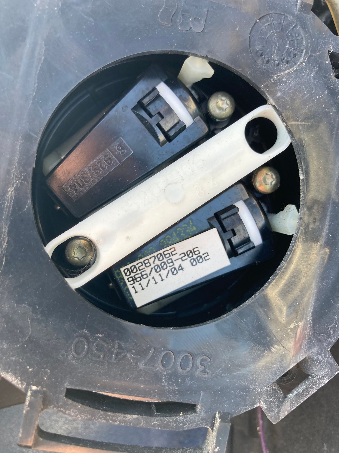

So far I’ve ascertained there was a 96-04 set of wing mirrors. Memory and non memory options, these had either a 5 or 12 way connector block. In the photo my one has an 8 way connector block so I’m assuming this mirror is a 05-06 variant.
looking on barrats
https://www.sngbarratt.com/English/#/UK/FindParts/Families/XK8%20~2F%20XKR/11/XK8%20~2F%20XKR%20-%20To%202006/47/EXTERIOR%20FITTINGS%20AND%20SUNROOF/12670/assembly/30436

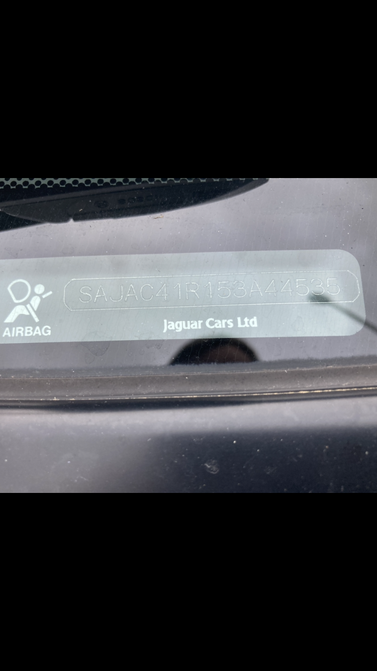

(My vin ends A44535)
I am not sure what a power park mirror is, but the option without doesn’t go up to my vin. (Only goes up to A40624.) Therefore I’ve followed the power park, memory flow down and selected pn C2N2932 as this part is for post vin A40265.
If this is the right part then there’s a couple new on eBay (one in Canada one in Lithuania) so should be ok.
