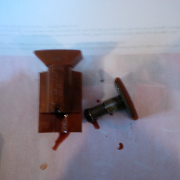

noterman, I wouldn't reuse dented pistons, I did that on a motorcycle once and ended up with a rod through the case. Engine gone.
Toykorich, The dealer in Halifax told me the same thing. Never seen a secondary tensioner fail. However this is a picture of my passenger side tensioner when I removed it. 54000 miles and it crumbled in my hand like a wet sweet tart.
