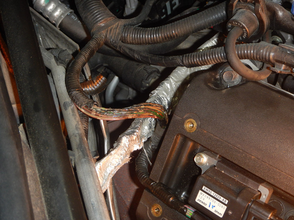

I did discover the LHS wiring harness resting very nearly on the LHS exhaust manifold, some lazy owner or mechanic in the past must have mis-routed it. The plastic wrapper is brittle, and the individual wire insulation seems intact but brittle. Not sure if this could be my problem or not, or how to confirm. See the images at the end of the video - I zoomed in on the wiring harness.

Soultec, you said you used some starter fluid, so a fuel issue should be out. I would try the inertia switch, just for the sake of it. Those wires look suspect but the sound is different???

Those wires would more likely cause a miss on one or more of the cylinders on that bank. If one of the lower chains broke or came off it might have knocked the other lower chain off also. If the cam covers were still off you could crank it while doing a video and see if the cams are turning.

But that wiring does look like a mess for sure. Maybe get one of those spark plug testers that plug into the boot and clip to ground... you can then look for spark on that side one plug at a time as someone turns the car over.

I would definitely address the wiring harness and the first generation tensioners, just read all of the post about people that ignored replacing these tensioners.

I would first be looking at the melted wire harnes. You should never use starter fluid on this car you can and will crack your intake manifold. It did sound like cylinder washing and would recommend that you read my procedure on no start.

Oil in the cylinders is the trick but first find out if you have fuel and spark and repair the known problems such as that wiring issue. Take Baby Steps! One thing at a time.
