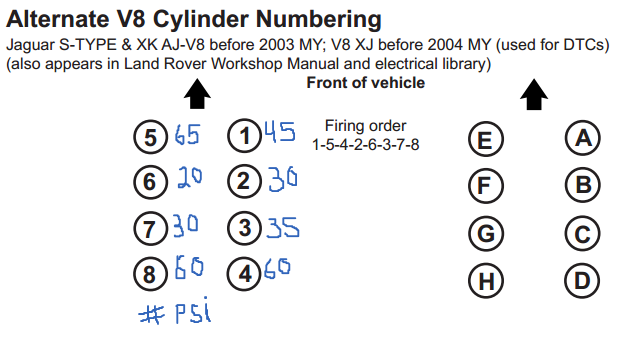

Hey guys, I ran the compression test and spark tests on all eight cylinders.
Tested all eight wiring harness points and all eight coils with spark confirmed all the way around.
Compression results were all over the board. I've attached a picture depicting the results.
I also smelled fuel throughout the compression test so as Dave said, I just keep adding to the likelyhood that I have wash.
Next up is the oiling procedure.
Those are really low but its odd the inner cylinders are worse. But the starter fluid may have gone mostly to the inner cylinders.
