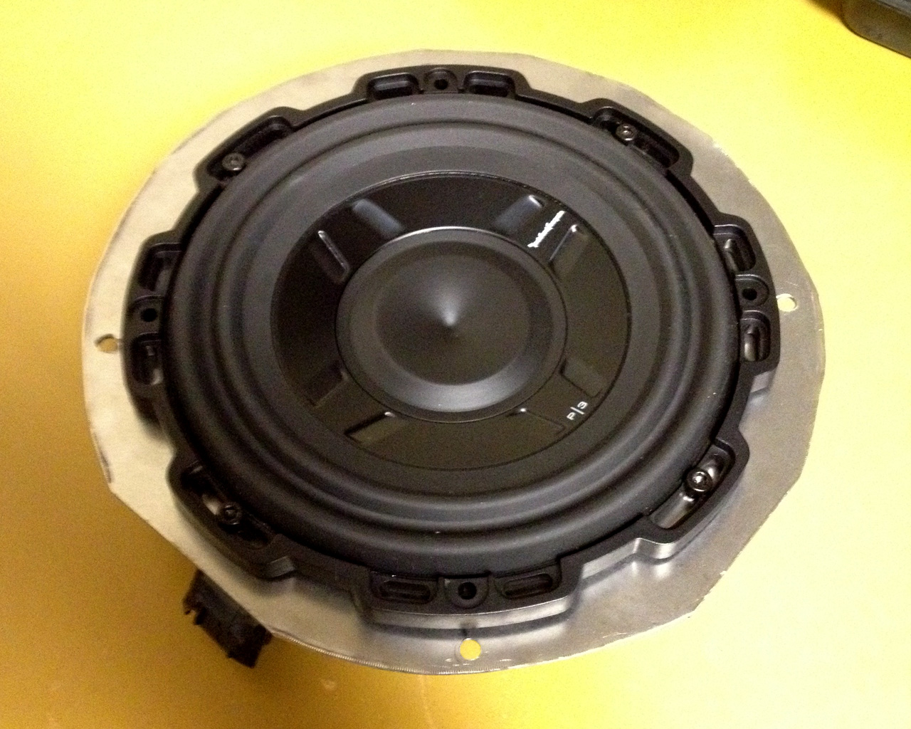

This weekend I installed the Polk Audio DB651s in the rear sides and Rockford Fosgate P3SD2-8.
The 651s fits perfectly in the opening and the integrated tweater is flush with the top surface of the mid, so no issues with the stock speaker grill.
The sub was some work to get installed. The opening is too large for a standard 8" and not large enough for a 10".
Rather than cutting on the car, I went the route of making an adapter plate out of some sheet steel. It's not pretty, but gets the job done.

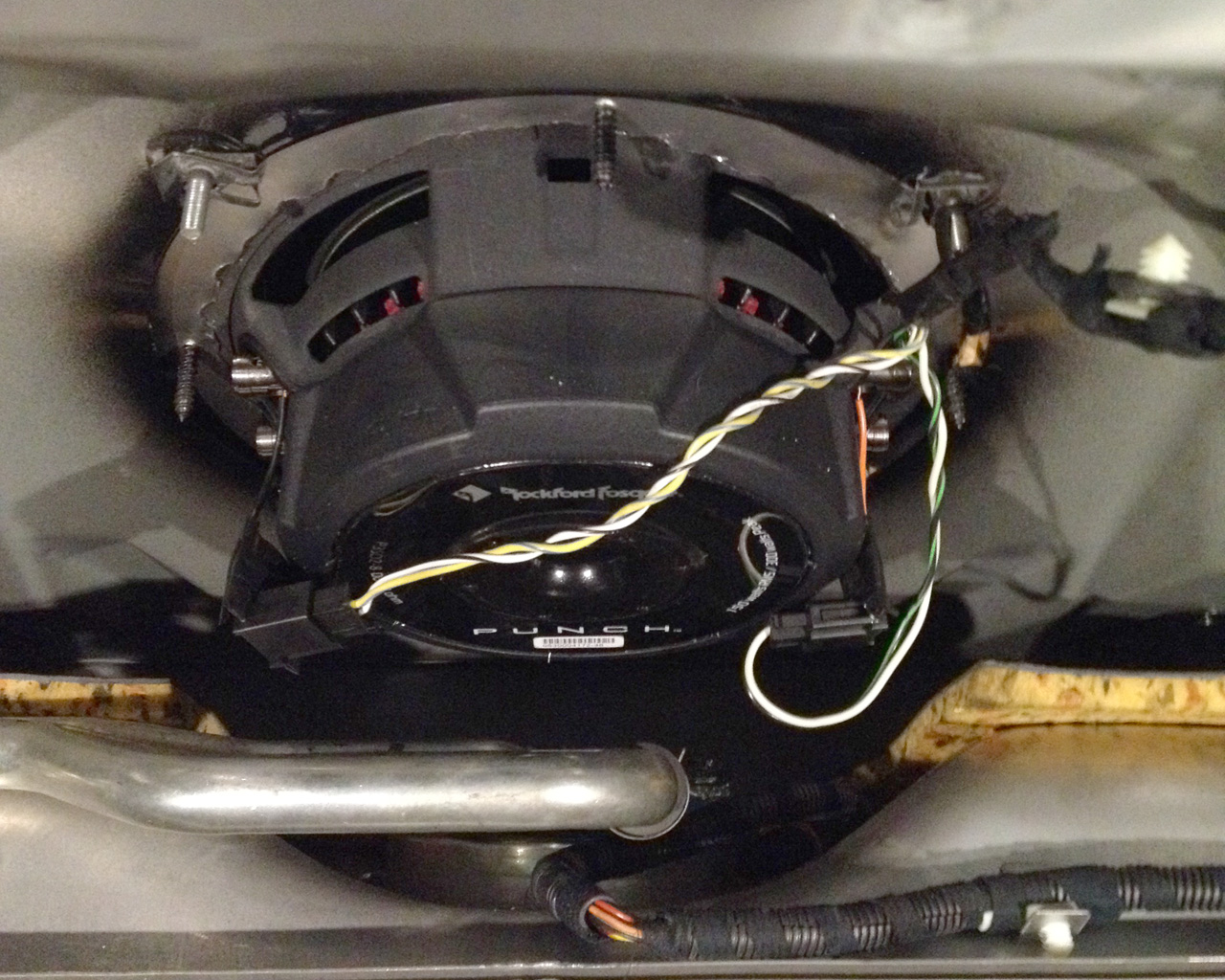

Once installed there is as much or maybe a little more clearance to the gas tank than the stock speaker.
