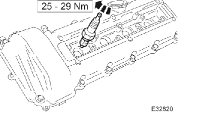

Here ya go

i think 25nm is if you put the old plugs back and 29nm is when you are fitting new plugs
