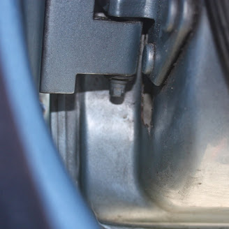

Funny you should say its unusual as my Inde showed me a split in the metal behind/side the hinge on my door and two other XK`s in his yard.
If you can take a photo of the area door side of bottom hinge, you can see it for yourself. Its not the hinge but a crack in the metal, lifting the door just causes more damage to this area

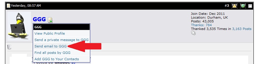

It looks like you are having problems posting a photo. If you email it to me, I'll add it to your post.
Right click on forum name GGG in any of my posts and select Send email to GGG (arrowed in red):
Attach the photo to your eMail in the usual way.

Done it! As you can see there`s a hole under the hinge with distortion on the door ,I saw this on two other xk`s When lifting the door, all you do is distort the metal supporting the door hinge.
£50 repair that`s nothing to do with the hinge itself

I would say you have a problem, It looks worst than just a crack. I would have it repaired, weld the crack and have a stiffener tacked in the inside. My car was a first owner Texas car has never been exposed to salt, Along with my friends, his has never been exposed to road salt. I see you live on the Isle do you think that corrosion could have weakened the inner door frame? we have seen a lot of the older XK's in England deteriorating. from salt. Tony XK Racer has posted many repairs he has made. He could probably shed some light on the subject.

.My independent said it is a common thing to find on XK`s doors. It`s quite difficult to see just looking ,you need to get a small camera/phone in the gap to see it properly
