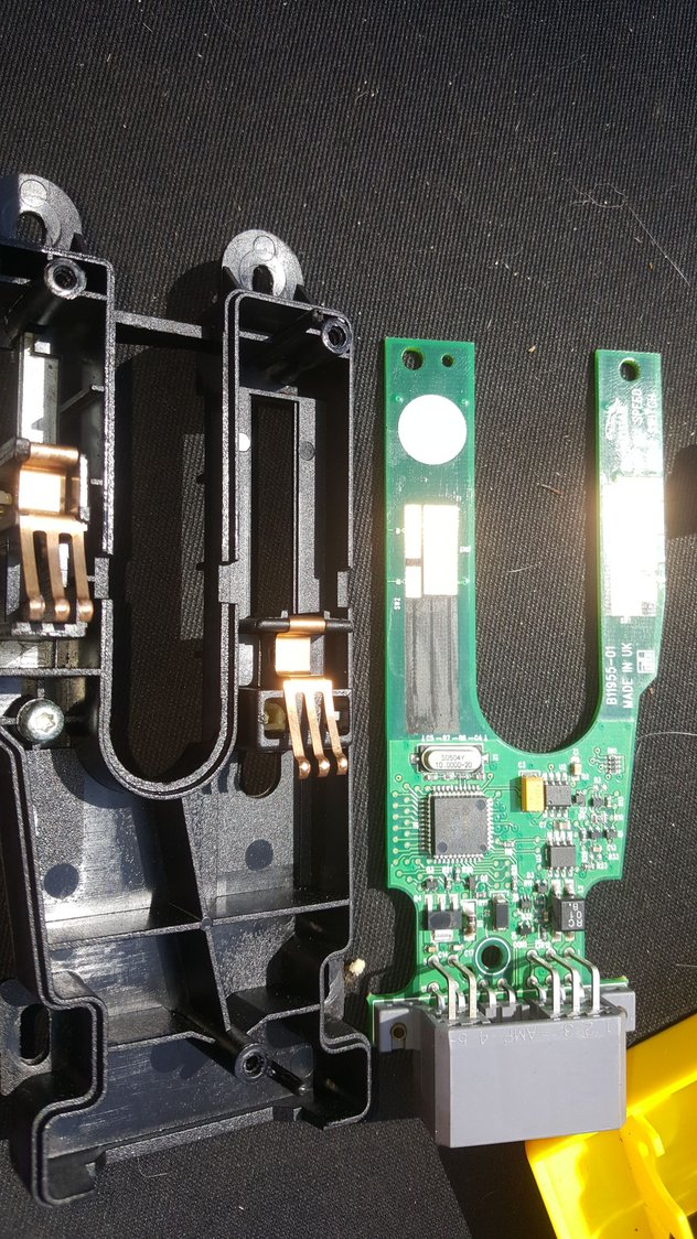

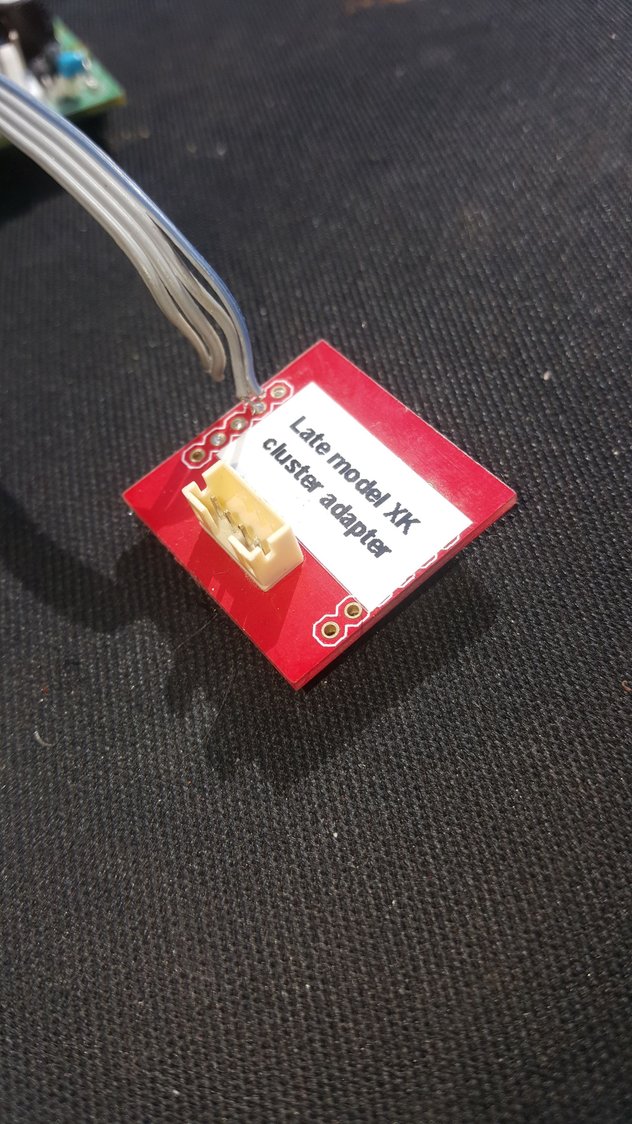

BTW... This is what I found of the "Realgauge" system... I since resolder and replaced. Ashamed to show my soldering job but I think it's ok.

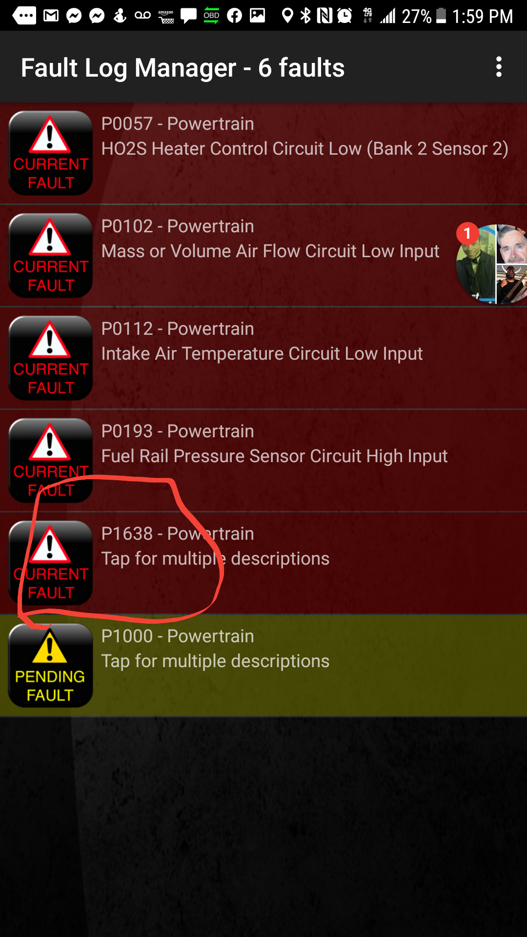

And then there's this. The dreaded P1638!!!
Mind you,,, the connector above.
Are things starting to make sense?
Wouldn't that be something, if !?!?!
Except for the 02 sensor DTC (and the dreaded P1638) I caused all the other faults...

Trying to solder that real gauge component,,, it's the size of a nickel, smaller than a quarter!!! I'm going to remove it ALL for now.

​​​​​Something came back to life tho, it seems. I'll look back and look at some of the OBD screen shots, but I think this is the fist time I've seen the p1638 code describing a dead or faulty instrument cluster (IC)... From 2003 on, the IC plays an integral role in start up, and other things "passive security".
In other threads I've read where folks say when they get the p1638 code the car shuts down immediately and will not start. The p1260 describes a fault in the conversation (with sub faults when using a better code reader) between individual components of the start up challenges. From the key to the relay itself.

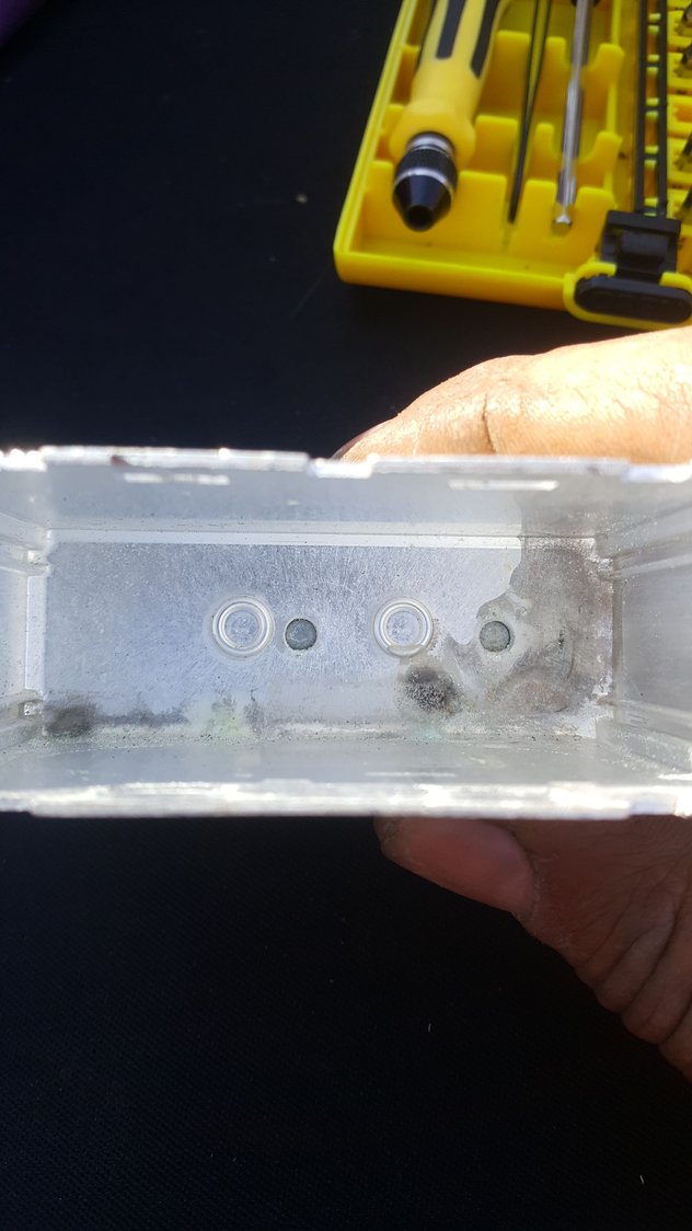

Inside module case
KLM innerdz...
