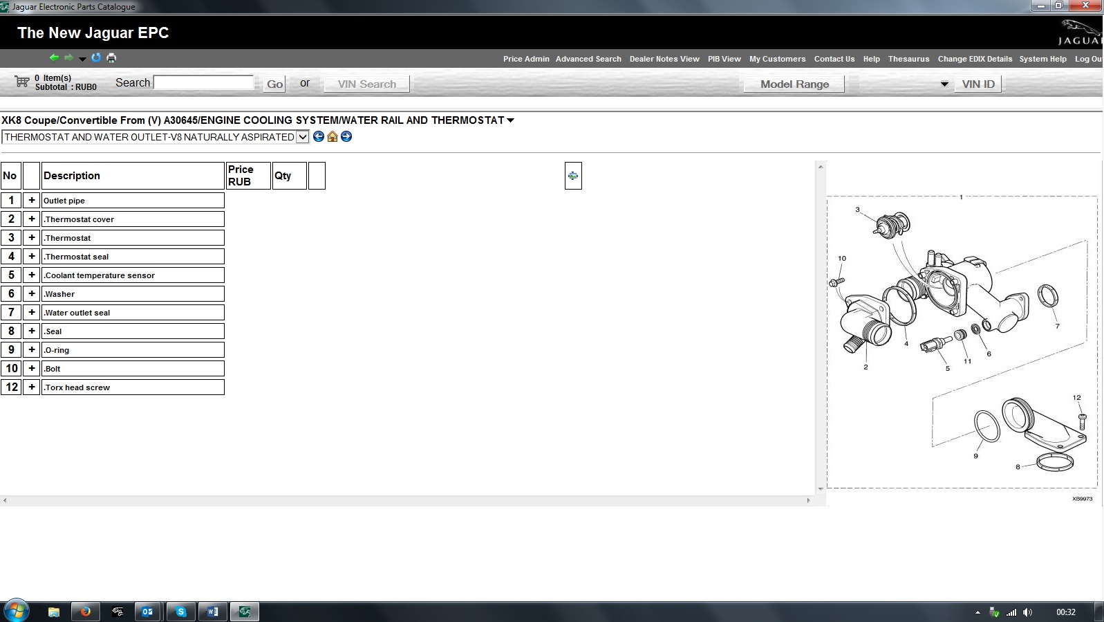

Old Aug 6, 2014 | 06:40 PM
With profound apologies for my tardy response.
The Parts Catalogue shows all the seals:
The relevant section from JTIS:
JTIS - XK8 2003 Thermostat.pdf
Attached Thumbnails 2003 T-stat replacement, what will I need?-xk8-2003-thermostat.jpg

Old Aug 6, 2014 | 07:26 PM
brgjag's Avatar
Joined: Aug 2008
Posts: 2,904
Likes: 364
From: SW OH
I found that diagram on ebay that was in a sale of a unit, ha ha ha, so I bought it. Got a resivor cap also, deciding if I should go and do the rad hoses and that hose that runs from housing under the intake to the TB, which is what house and can I just shove it under the intake to get it off and back on?
