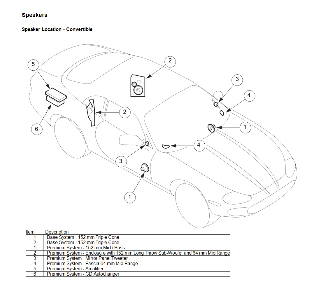

the model I am asking about is a 2003 XK8 convertible with the premium sound system...
Old May 13, 2013 | 08:22 AM
Here's the speaker layout for the Convertible Premium Sound System:
Those rear speaker housings could limit your options on replacements.
Attached Thumbnails 2003 XK8 Alpine(premium) Sound System-xk8-convertible-speakers.jpg

One question....
By triple cone, do you mean three-way? Stereo newbie...

Ignore the '152mm Triple Cone' items 1 and 2 on the list - these are the Base System and not your Premium System.
