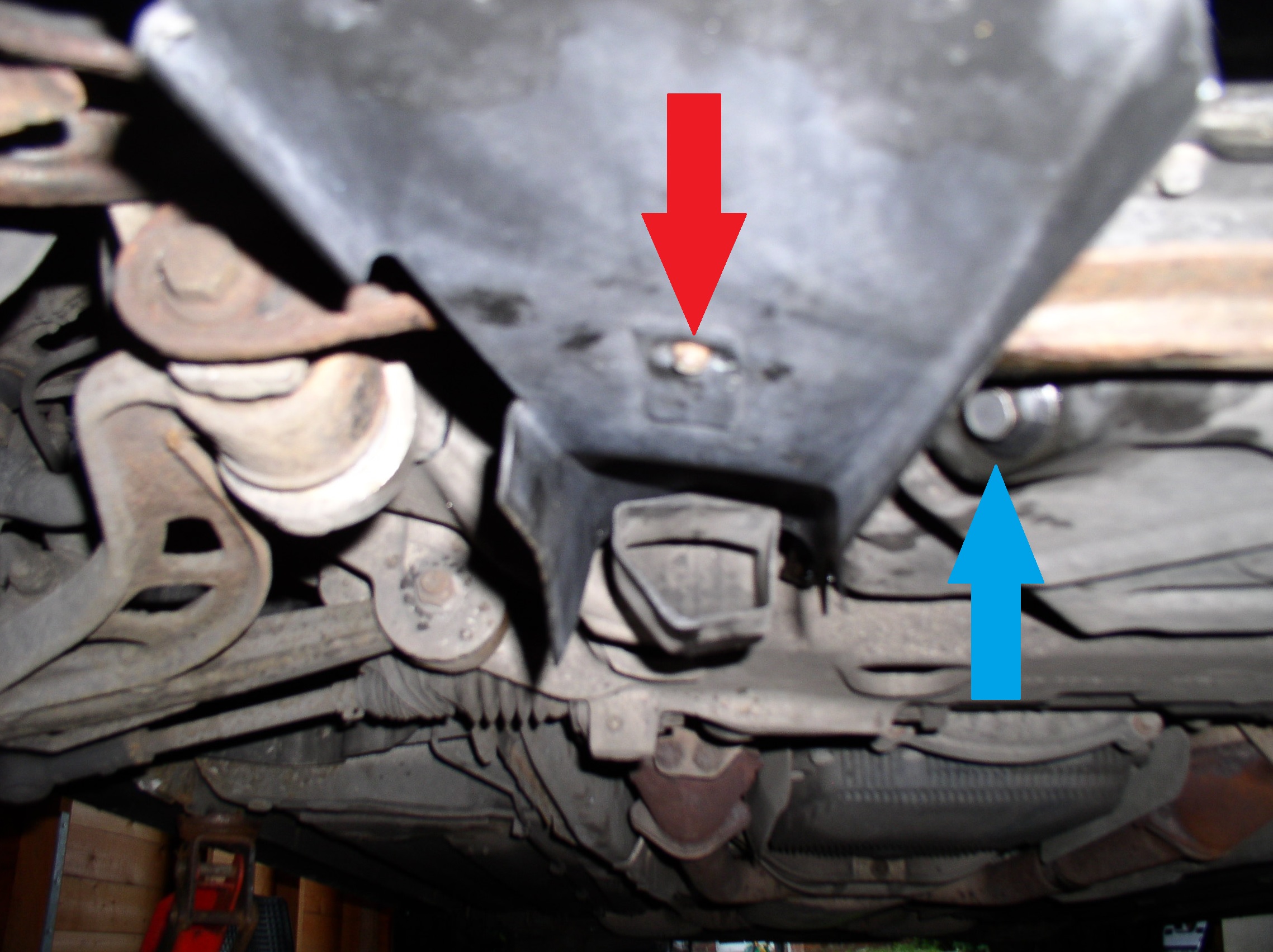

No need to make any apologies for "newb" questions.
Refill capacity (including Oil Filter) is 7.4 US Quarts (7.0 Litres).
For identification purposes, Left and Right are always relative to standing at the rear of the vehicle looking forwards.
The Oil Filter is RH side of the engine above the Oil Pan. Drain Plug is RH front corner of the Pan (arrowed in blue).
You will need to remove the black plastic Alternator Cooling Duct (secured with one hex bolt - arrowed in red) to access the Oil Filter which is above it.
The Duct is often missing and the subject of much discussion on the forum as to whether it serves any useful purpose!
