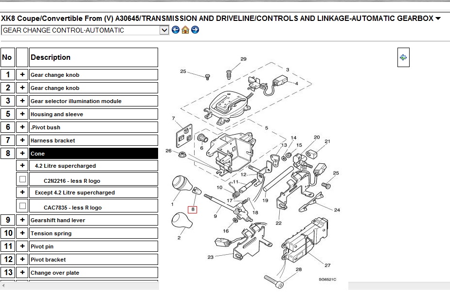

There is an unbelievable number of Gear Change Knobs (items 1 and 2) listed in the Parts Catalogue for the 4.2 Litre 2003/05 model but I can't find the P/N you quoted for an XK8/XKR.
That's the bad news. it gets better!
There's only two Gearshift Levers (item 9) listed and these are the same other than one is black and the other is chrome.
The Gear Change Knob is secured with a Cone (item 8). There's two different cones - one for Knobs without the 'R' logo and the other for Knobs with the 'R' logo.
Because there is only one design of Gear Lever, the internal thread on both of these Cones must be the same. The only difference is likely to be the external diameter to suit the base of the Gear Change Knob.
I've certainly learned a lot about Gear Change Knobs through looking all this up. I hope it helps you.

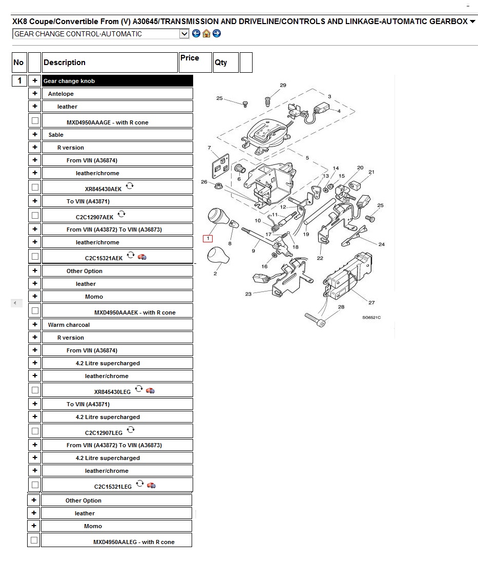

Thanks for your reply! Your information on the cone was very helpful. I'm wondering if you'd be able to provide an image of all of the part numbers for the various gear change knobs so that I could find a suitable replacement from the list to go along with the correct cone. Thanks again for your insight!
Matt
Old Nov 25, 2013 | 02:32 AM
Originally Posted by 01Silverstone
......... I'm wondering if you'd be able to provide an image of all of the part numbers for the various gear change knobs so that I could find a suitable replacement from the list to go along with the correct cone. ..........
Matt,
They are listed under items 1 and 2 on the drawing:
(click on the images to enlarge them)
Plenty to choose from!
