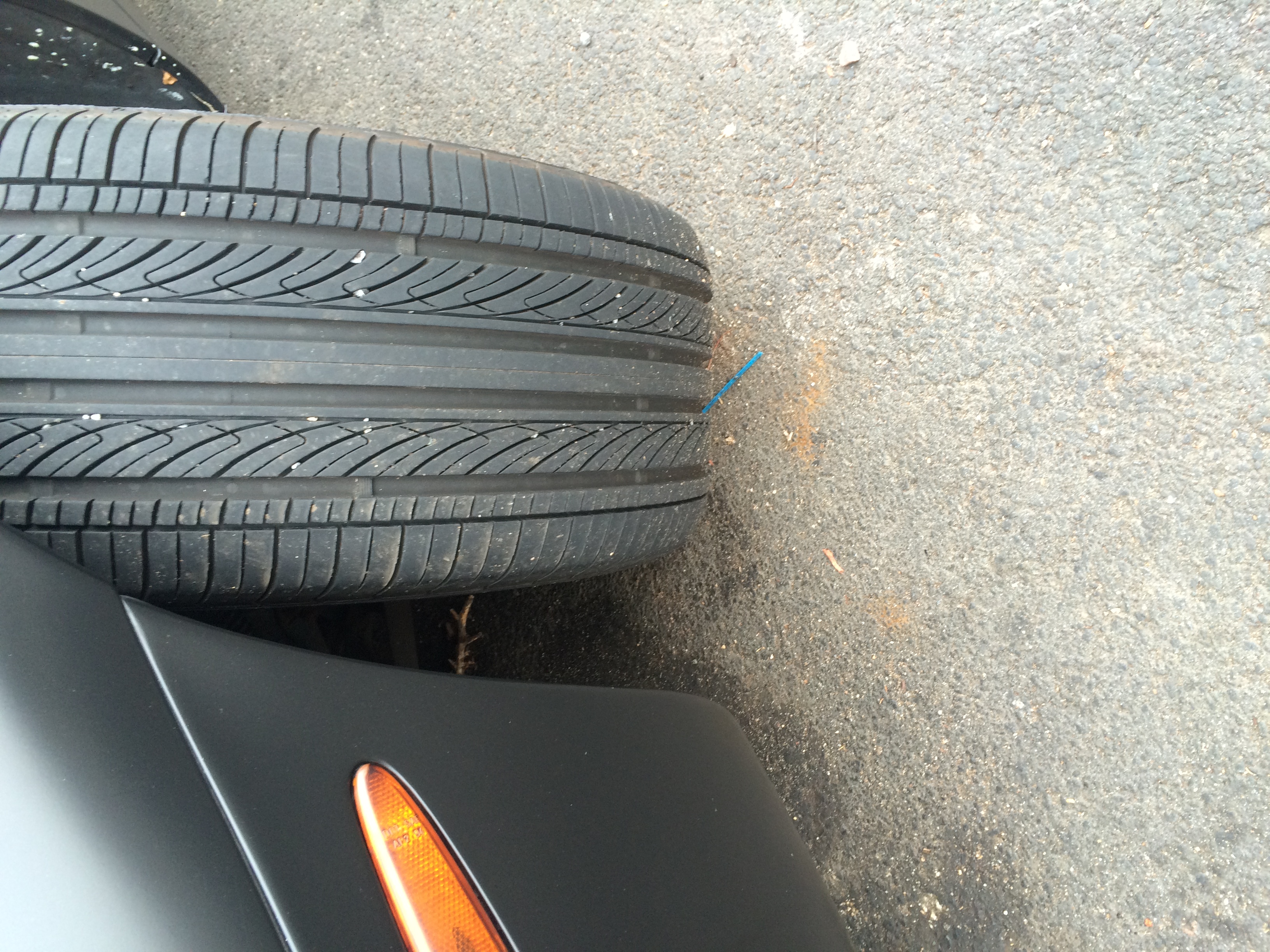

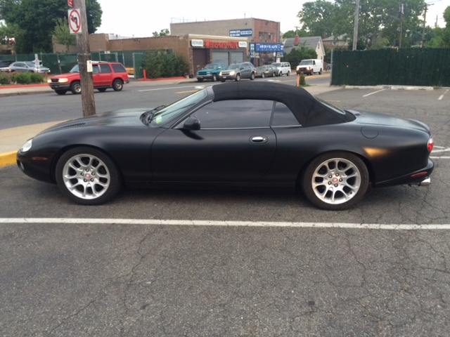

Originally Posted by GordoCatCar
If you lower it, the negative camber on the front end will increase the wear on the inside of your front tires. There is no camber adjustment readily available. Before someone jumps in with the eccentric bolt... it adjusts about a 1/16th of an inch... hardly a camber adjustment at all and certainly not enough to compensate for an inch drop of the Mina Springs.
Being I didn't do the job myself I really cant tell you what was done or how it was done. What I can say for sure is he did mention the eccentric bolts and something else perhaps for the rear.. Normally when there is a big camber issue you can see it in the wheels and I really don't see it at all. My old tires were just plain worn pretty evenly when I removed them. Just took a look at my new ones and I don't see any excessive wear however I did see what looks like a bit of feathering on the tires which could be due to a toe issue and perhaps combined with Camber. I should check the alignment but the car drives awfully straight, Anyway figured id attach some photos...I may try the under axle exhaust when I install my new blower an some other goodies I bene collecting. Currently have center resonator and rear cans removed with the Mina straight pipes,,,But I want a better sound quality.
