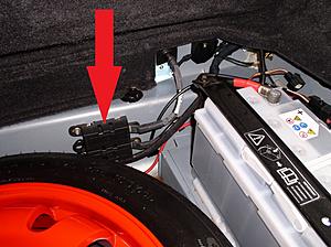

Originally Posted by Nick White
..... When I try and start it all the check lights come on but the engine wont turn over. .....
Welcome to the forum Nick,
There may be other faults with engine management but this is a fundamental power supply issue. Apart from a suspect battery (which is always the first thing to eliminate on these cars), one common cause of the Instrument Pack lights coming on but the engine not turning over is loose connections in the HPPM (High Power Protection Module):
The connections can slacken or the terminal ends break up.
