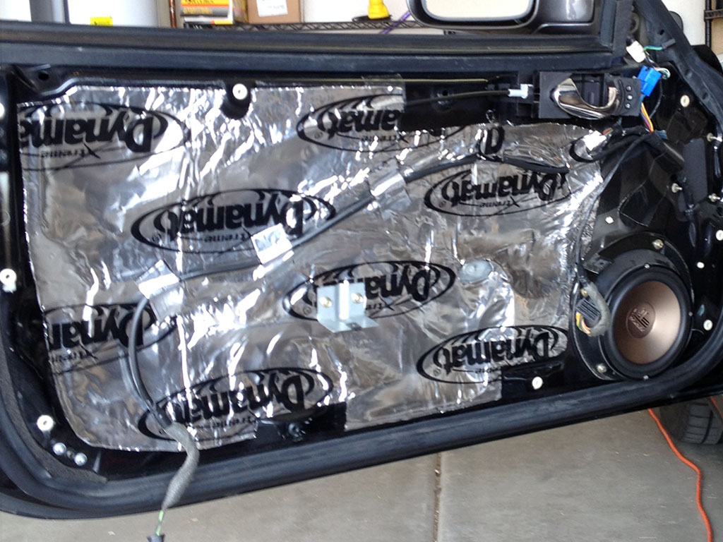

I'll try not to stray too far off topic, but can you explain how/where you installed the Dynamat in the doors?

I followed Frog's advice:
https://www.jaguarforums.com/forum/x...r-doors-51705/
Laid some inside the door against the outer door skin and also on the outside of the door box behind the door panel. Makes them feel very solid and they close with a good thud.
Final product looks like:
Thanks again to this forum, I covered both doors on the inside. Was an easy decision as the upper top door plugs had broken and the door panels started to do that 'limp hanging' which is worsened by an 8 yr old and 10 yr old trying to get comfy on their way to school.
I woe recommend to anyone switching the speakers to do the Dynamat first. It's a fun2 hour 'any idiot can do it' project and you will be able to tell the difference in music quality and sound level inside the car...even with the top down...before choosing your replacement speakers.
Attachment 55751
Oh thank God! I did mine and they look exactly like that. I. thought the pro's were going to laugh at my job when I dropped off my car to have them correctly wire 8 speaker wires. Sometimes it's really worth paying money to have something done right.
