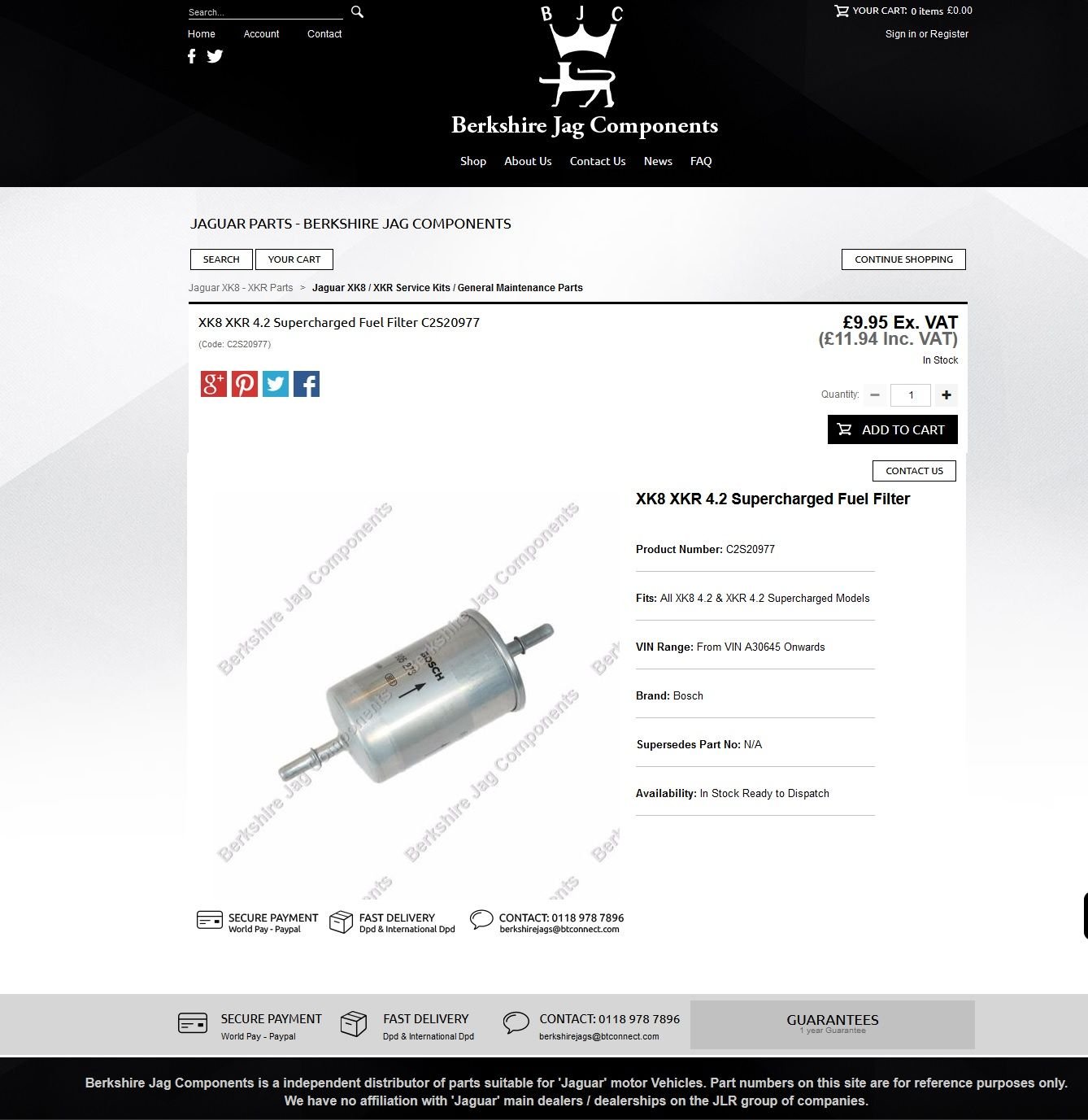

In addition to the WIX option you found, Berkshire Jag Components list a Bosch alternative:
Deliberately photographed to partially hide the P/N but I'm sure it wouldn't take much research to find it.
