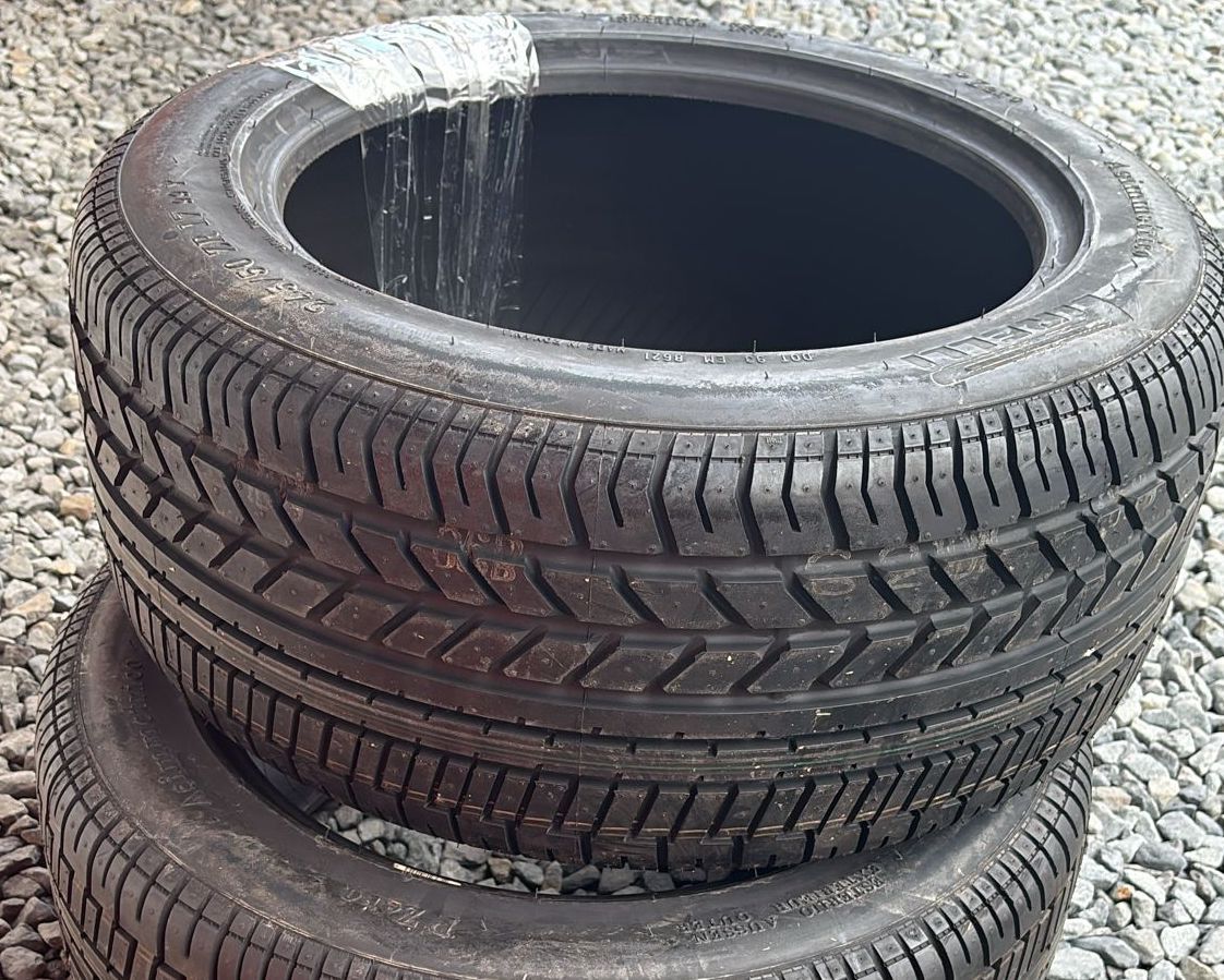

Default Bridgestone Potenza
HI! Be glad that you have such a wide selection of tires for 17"! I had 15-year-old 245/50 R17 Bridgestone Potenza on my XK8. I wanted to rejuvenate them a bit with newer ones, but I couldn't find them. Six months ago I managed to buy two "new" Potenzas, but they are 8 years old! Potenzas are good in that they are runflat, so if you have a puncture, you can drive as far as you need without the need for immediate repairs. But they also have the disadvantage that they are quite heavy, so as an unsprung part of the vehicle, they cause a lot of discomfort when driving if you have slack in the steering or they are not perfectly balanced. However, I can't buy new ones in the Czech Republic anymore. Now I have got two new Pirelli Assimetrico. Dot 2021, so great, even though they are not Runflat. I was also thinking about replacing the wheels with larger 18" ones, for which the tires are more affordable, but the 17" revolvers are broken on our road tires are more suitable.
I'm curious how the Pirelli will ride, I don't have them installed yet. I'm currently working on restoring some parts of the chassis, so I'll put new tires on after the work is finished.
