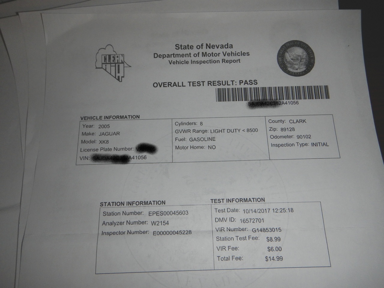

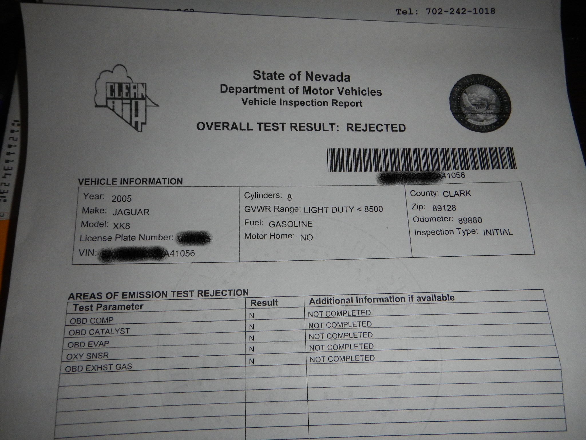

Razorboy, Funny you should mention this; I had a total rejection myself just yesterday. Seems this is a very common problem with a great many Jaguars. Apparently, disconnecting the battery or clearing old error codes will reset emission parameters to zero. You can drive 1,000 miles and never get a single parameter to register, if you don't put the car through it's paces. At the recommendation of the independent shop that smogged my car, I drove about 150+ miles at 60 to 70 mph and went back before closing. 3 of the 5 parameters showed "Completed" but the O2 sensor and the "OBD Complete" were still "Incomplete." I found this website last night and learned what to do, and today I passed with all 5 "Completed" with only an hour's time invested:
https://www.obd-codes.com/jaguar-drive-cycle
The indy shop owner reiterated what I learned elsewhere online last night, that we need to drive about 300 miles in the week before getting the car smogged. For the O2 drive cycle, the hardest part is finding a stretch of road where you can speed up, slow down, speed up, slow down, idle on the side of the road for 11 minutes, drive at a steady 30-60 mph for 10 minutes, then push it up over 3,000 rpm in 4th gear (= about 70 mph), then coast for 30 seconds, (all without getting pulled over for driving erratically).
Driving continuously about 50-75 miles then doing the O2 sensors drive cycle will probably clear them both, which will in turn complete the "Comp Complete". Let me know when you have the time to do it and I'll be glad to come over and ride shotgun with you.
