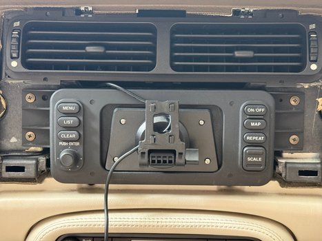

champir's Avatar
Posts: 114
Likes: 75
From: Australia
Default SatNav Replacement
I originally came across this Joying Head Unit Screen Mount for Jaguar XK8/XKR by Russell_S on Thingiverse ( https://www.thingiverse.com/thing:4186500 ) to suit mounting a modern touchscreen over the existing SatNav spot.
I was considering this approach however in the end I designed a plate that clips into existing SatNav unit facia to mount a Carpuride W903 unit using a modified Portable Sticker Bracket (because they sent me the wrong one).
I disassembled the Jaguar SatNav and retained the plastic surround with the buttons as they are a little visible behind the unit. I used knurled insert nuts and M3 hex bolts to secure the mount.
Printed it in ABS to withstand the harsh Australian summer temperatures. I have been happy with both the unit and the mounting solution as it has remained functional and adds carplay to my car.
I was planning to tap into the audio out of the unit and feed it into the plugs available from the old SatNav but haven't gotten around to it as yet. If I can find some compatible plugs/sockets used there I might give it a go soon.

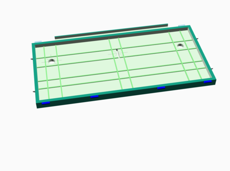

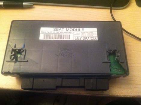

champir's Avatar
Posts: 114
Likes: 75
From: Australia
I made this replacement mount for the seat control Xk8 module which is prone to cracking.The module is bolted under the front of each seat in Jaguar X100 models 2001-2005. Modules are part number LJE2160AB/XXX.
Replacement lids are available (Part number C2N3565) however I decided to print my own.
Jaguar TSB 419-17 describes the problem further.
https://www.thingiverse.com/thing:4338477
