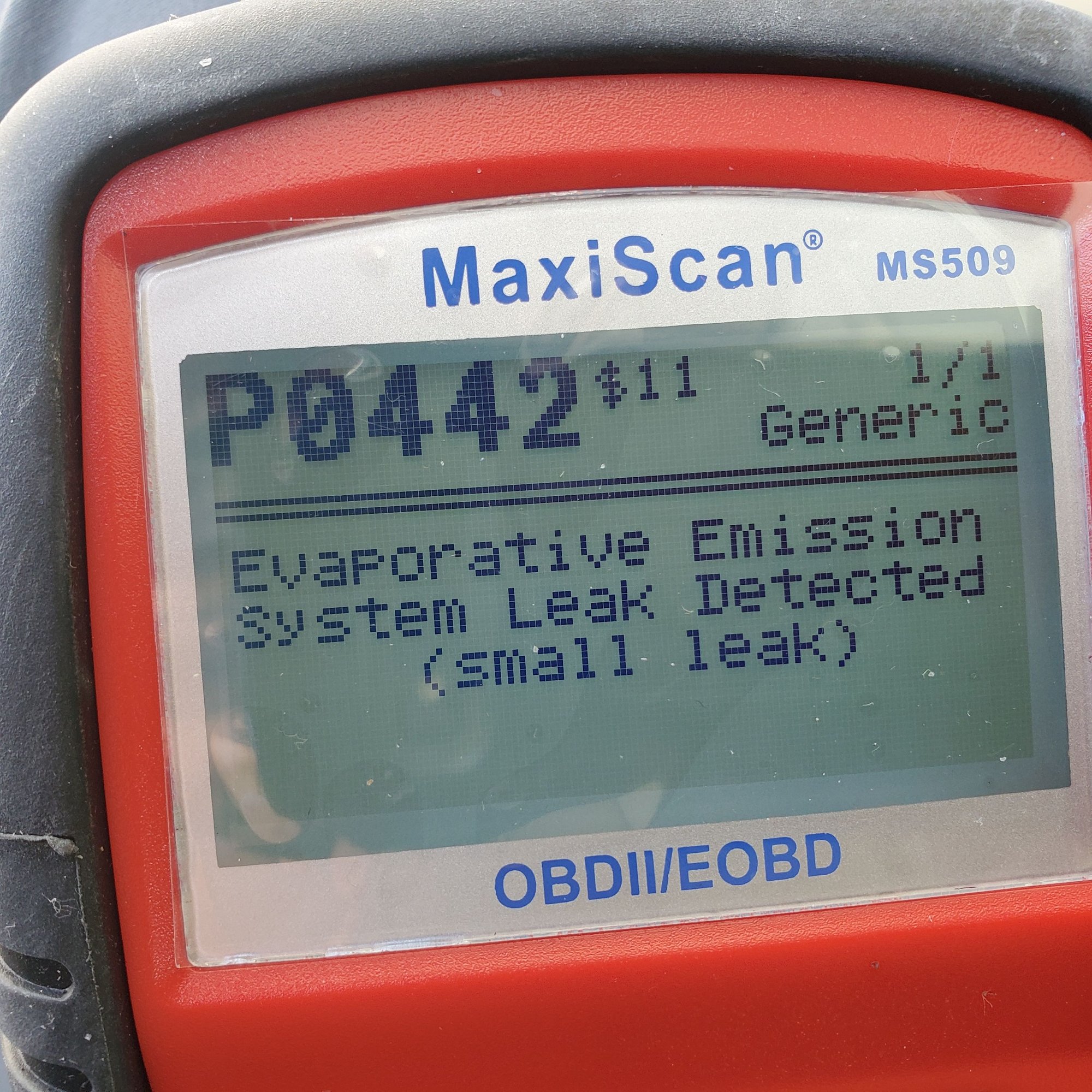

Ok I got 1 code pop up - P0442 Evaporative Emission system leak detected (small leak) SEE PIC
how critical is this ?

I had this code on mine, turned out to be the rubber hoses to the charcoal canisters that are sandwiched between the chassis and rear subframe. They had disintegrated.
Could be something as simple as an O-ring in the evap system or even the fuel filler cap being open.

Yes you have a leak in the EVAP system somewhere. Note that it says small as there is another code for large leaks. Most common way to trouble shoot EVAP problems is the smoke test. EVAP is evaporative emissions so mainly gas fumes from the gas tank. There is a pump that sucks fumes into the charcoal canister thru some valves. When the car is running under certain conditions these valves open and the car can draw these waste gas fumes back out of the charcoal canister and back into the engine to be burned.

So you could just live with it? EVAP problems don't cause running or driving issues it's just a small bit of gas fumes we are talking about here. EVAP codes are a problem because of the expense of the repair and the fact that in most states your required to have them set before passing emissions. The pump and some of the hardware is above the rear sub frame.
Dropping this to get to the pump is NOT fun!

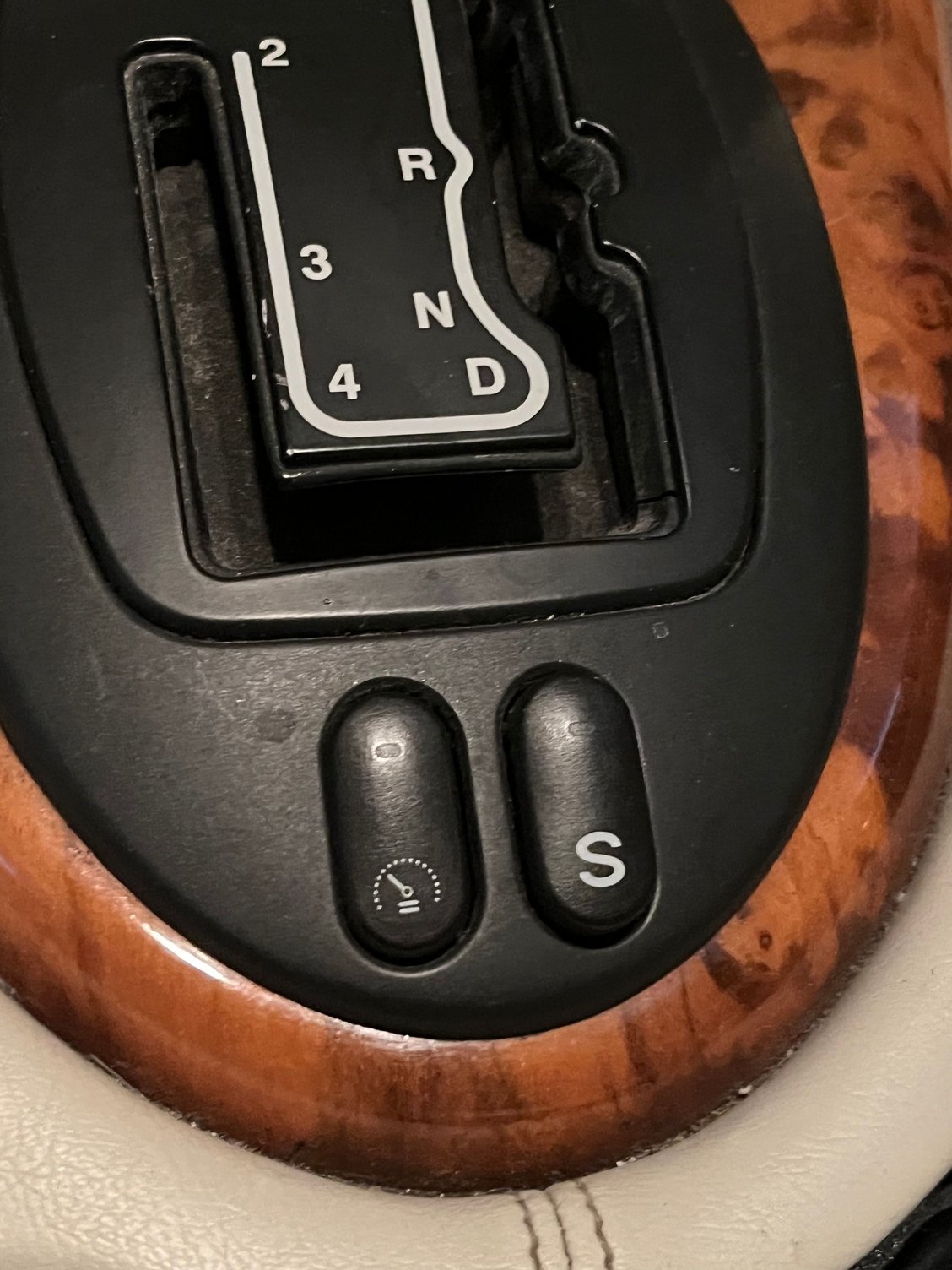

ZRAY
thanks again...all great info...this is all helpful since i am new to the car and dont have a manual
where is the "performance button " located?
TD
Old Jan 26, 2023 | 02:33 PM
  #38
zray's Avatar
Joined: Jan 2018
Posts: 3,722
Likes: 2,319
Originally Posted by JAG8GUY
ZRAY
TD
I imagine the old timers are laughing at my terminology.
Jaguar calls it the “Sport Mode”
Z

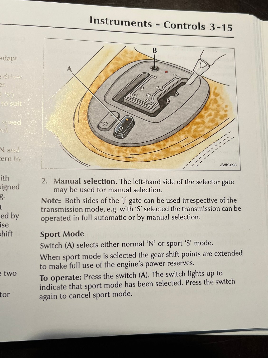

Old Jan 26, 2023 | 02:58 PM
  #39
JAG8GUY's Avatar
Joined: Jan 2023
Posts: 46
Likes: 21
wow thanks loads..that diagram pic helped a lot !
I got to get buy a manual or download one !
TD
