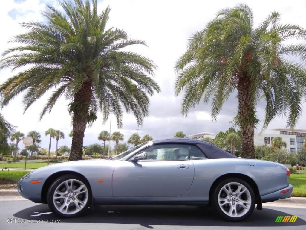

What is the color combination?...coupe or convertible?
just curious and would like to see a pict or two.

WJ..its Zircon Blue w/ ivory interior.

Beautiful, thanks.
