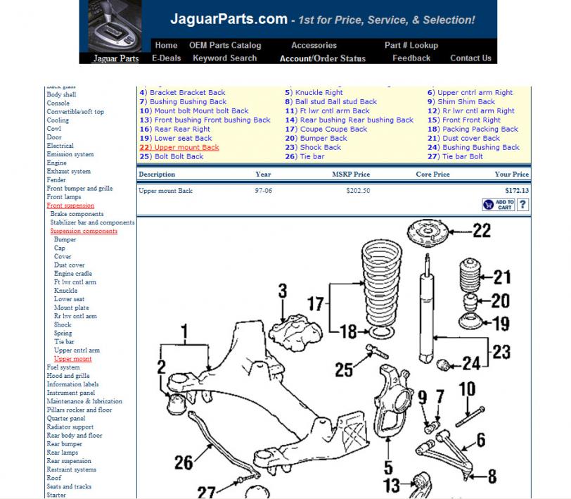

All you need from bilstein are the shocks, just reuse the bellows and stop that all already on the car. The bellows and stop do nothing but sit there. your front would have to travel about 3-4 inches before it even touches the foam stopper.
If your going to change the top mounts go to jaguarparts.com they have them for $172.13 each. They are called Upper Mount.
I attached some images, one of the jaguar parts screen and a couple of what the mount looks like as I'm in the midst of changing mine. I did the drivers side but still waiting for the passenger. The only part you really need is the big toilet seal looking thing. They have another piece of the same material sandwiched between the part with the studs but I don't know how much that part actually wears. It's riveted between the two plates that make up the upper part. The lower ring is steel with rubber molded around it. I took dimensions from all the parts because in the future I will make my own. I still have to deterime the proper derometer of the material but still alot cheaper than $350.00 for upper mounts. I Don't see why they just can't sell the foam ring (yeah I do $$$$$)
Hope this helps and good luck.
