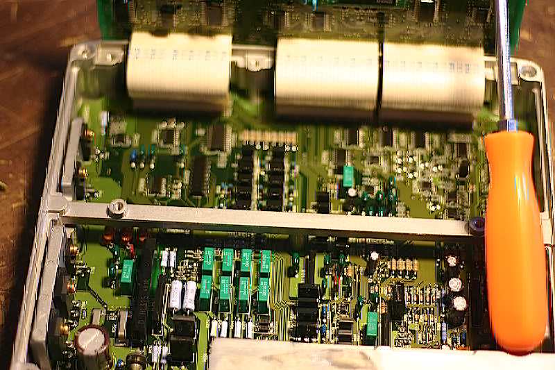

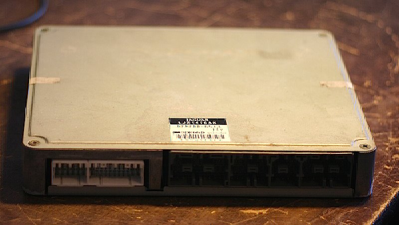

It stopped raining so I went and pulled the ECU. Someone had been there before as one of the 4 screws holding the plastic cover on was cross-threaded and one of the 4 Philips screws that hold the ECU cover on was rounded out. I didn't see any sign of leaking capacitors in the ECU, in fact it looked pristine inside. So if its the problem I'll have to send it out. I cleaned all the connectors and put it all back together.
Now the problem is slightly different. Same codes except now the P1111 is P1000 because I had the power disconnected. But, now the engine stays running and sounds like a definite miss. After it runs a short time you can smell unburnt gas out the exhaust. So I didn't let it run for to long. Also no more red dash light just the amber. But now it also gets "Traction Fault'. Same 4 codes for same cylinders.
I am beginning to wonder if its just one bad coil/plug but it thinks there are 4 bad ones.
Tomorrow I am going to start switching coils and see if the codes change.
Dave

So far all the codes seem to appear at once each time after a clear. Just for gits and shiggles I was thinking of swapping all the coils in pairs at once. If the codes change then at least I will know it is a bad coil causing all this. If the codes stay the same then its probably the ECU. After I started smelling the unburnt gas I didn't want to leave it running. But that would say there is a dead miss and the gas isn't getting used and just blowing out the exhaust.
This last time I had it running it also made a sound like the power steering pump low on fluid but it isn't and hasn't made noise before. But when I got out of car to get near the engine to try and locate where it was coming from it faded away so I have no idea what was doing it.

I tried the coil swap with mine and the codes didn't change. That's when I decided the ECU was at fault.

I just found another thread here with the same exact codes and his fix was the ECU also, Guess I'll pull it again tomorrow and send it to ASI...

The ECU is off to ASI and Brandon there said he will let me know what he finds.

I just heard from ASI. They did indeed find a problem with the ECU. They wouldn't go into detail because I guess they don't want to give away what part they replace. They did say it was a part that commonly fails in these. I did look it over really well before I sent it to make sure it wasn't something obvious like a leaking capacitor etc and didn't see anything visibly wrong. So its being shipped put today and should have it by Thursday or Friday. And if I am really lucky the car will be back on the road.
