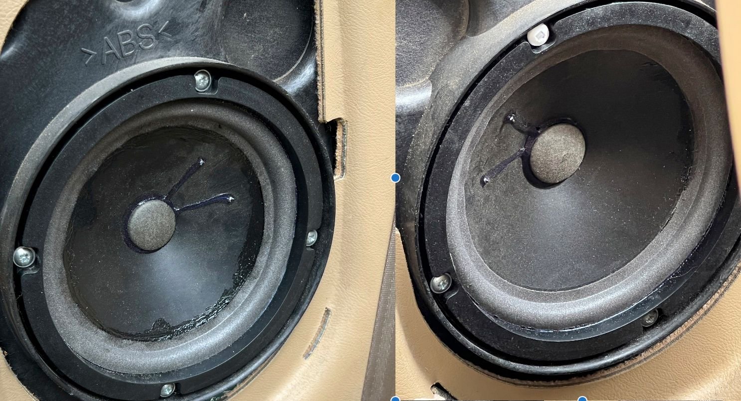

Finished fitting the repaired factory sub's and I have amazing sound. This is definitely the way to go. However, it takes quite a delicate touch to get the glue to seal well whilst keeping the cone centered - I had to redo one of them twice to finally keep it from rubbing.
They're not pretty, but they definitely give the kind of factory sound the car wants to produce:
don't look too close at the glue job!
As always, thanks for the advice!
