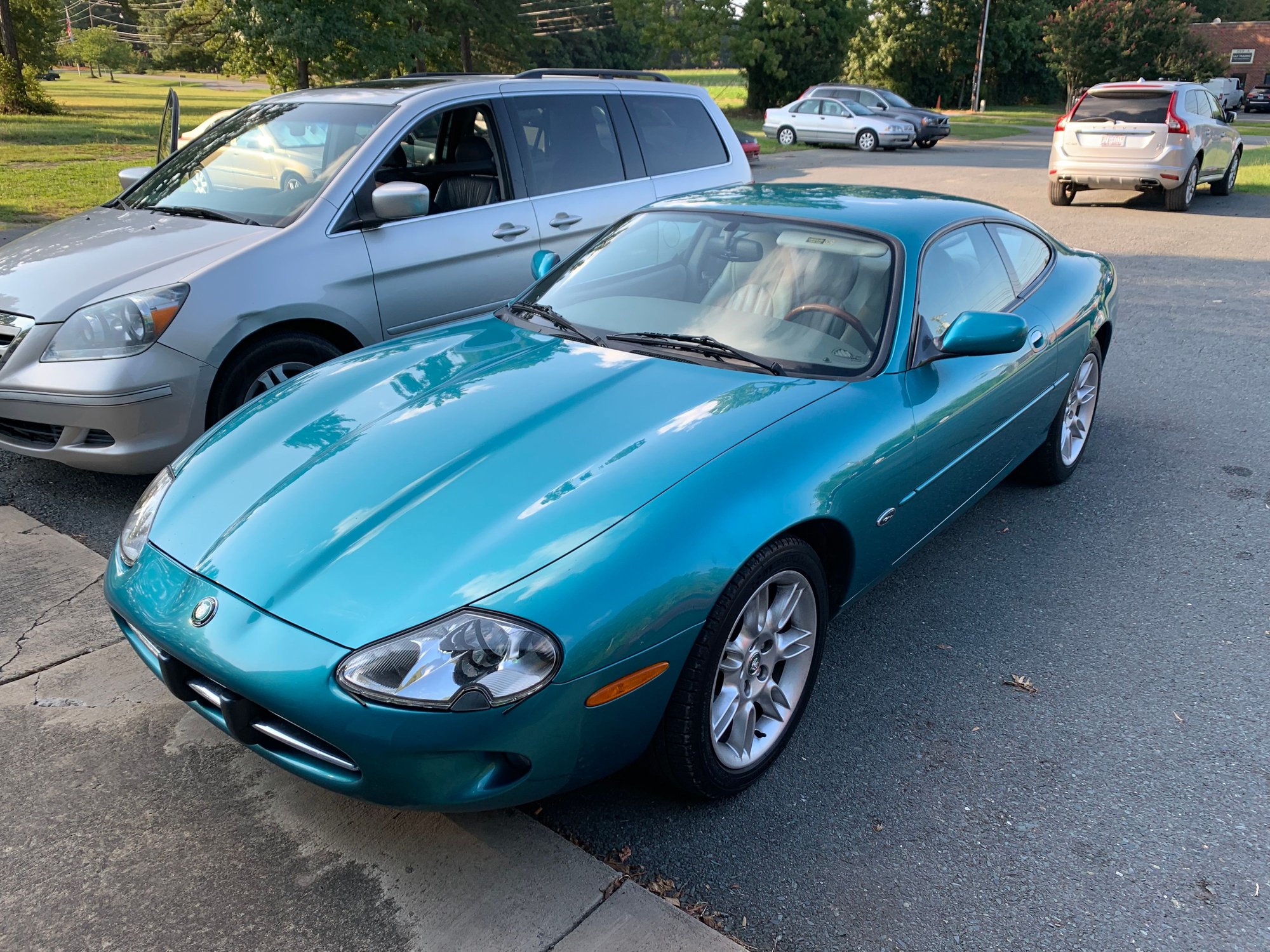

That is a gorgeous coupe Somebody needs to fix it!
