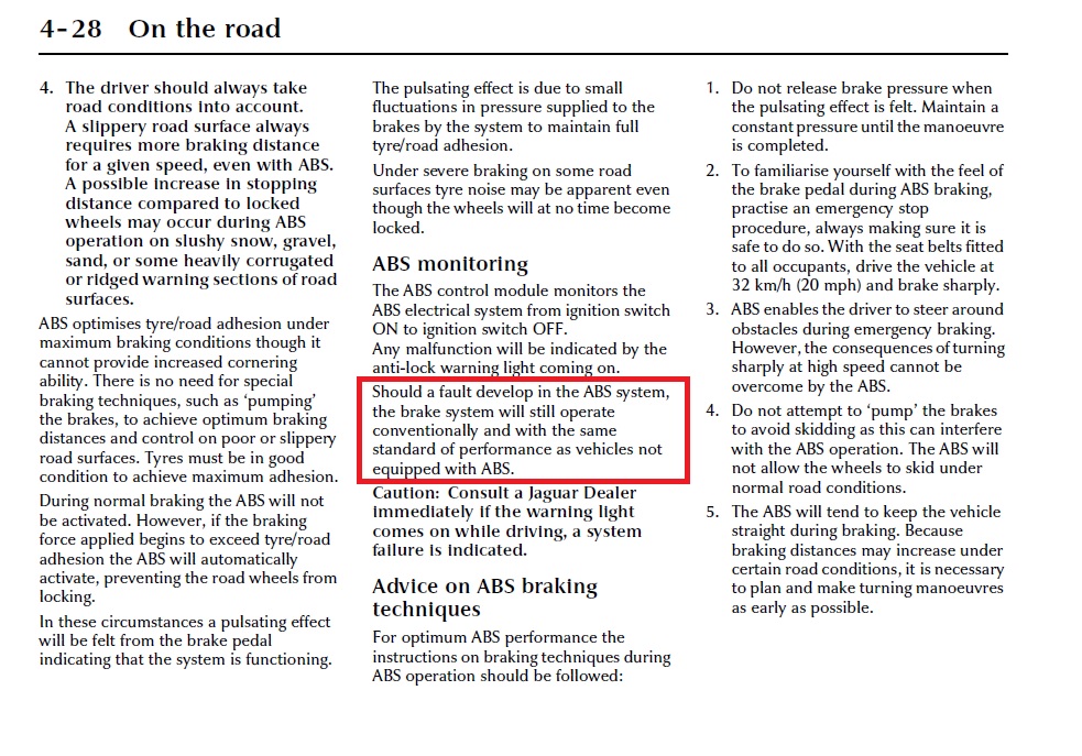

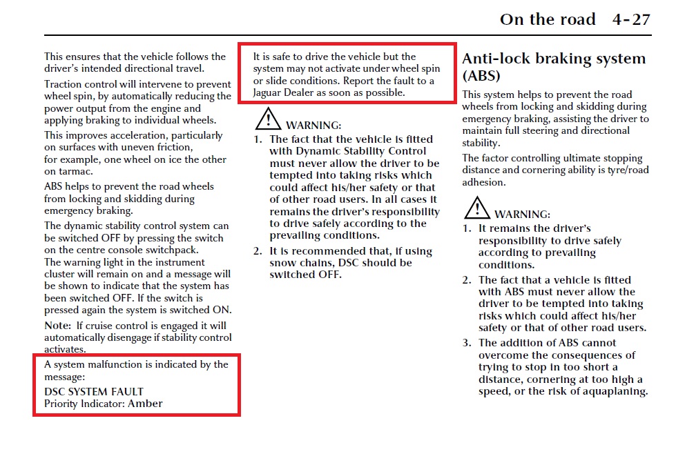

Old Apr 8, 2013 | 03:56 AM
Originally Posted by dodgerjames
no good at repairs,but i did re-set my windows the other day so it looks like a repair man for me, is it dangerous to drive? and many thanks
It is NOT dangerous to drive.
When the ABS and DSC warnings are showing, the vehicle behaves as if these systems were not fitted (see sections I've boxed in red for DSC):
And for the ABS:
