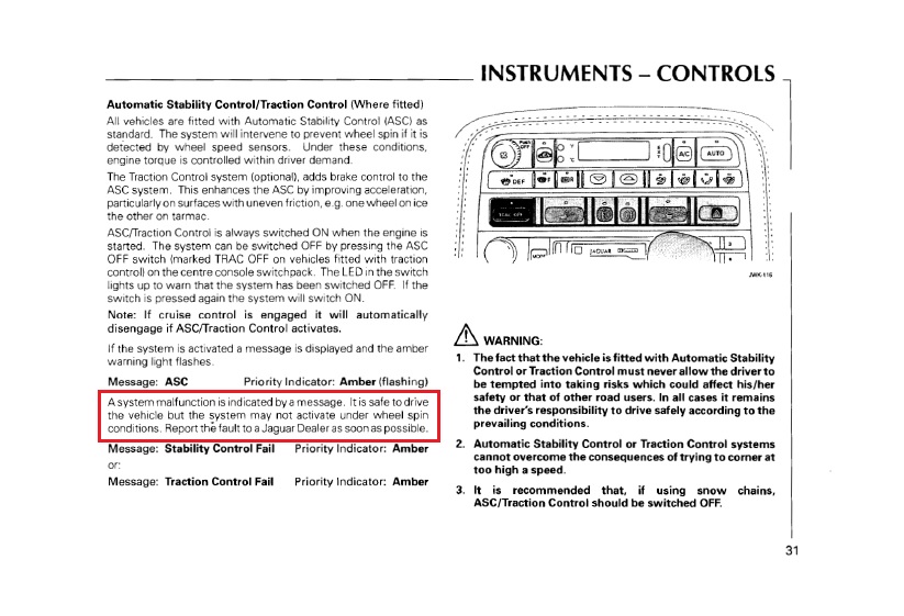

Originally Posted by dianeharsha
.......... It is ok to drive? I need to take a 150 mile trip tomorrow. ..............
Welcome to the forum Diane,
It is OK to drive BUT be aware the Stability Control System may not activate under wheelspin conditions (see section boxed in red):
ABS/Stability Control Fail warning-stability.jpg
